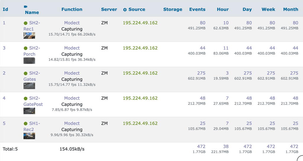

                          #29
                          update on disk used
                          it's definitely recording (can do playback on a camera)
                          Now has 5 cameras using 'Modect' (motion detect / record)
                          Terminal shows :
                          root@cac0ee46-aded-4b89-9498-d0c84f06018d:/# du -sh /app/data
                          2.0G    /app/data
                          so ~1Gb increase in 4 hours but it's an office so quite busy coming and going
                          ZM browser shows 472 events using 1.77Gb
                          humptyH 1 Reply Last reply
