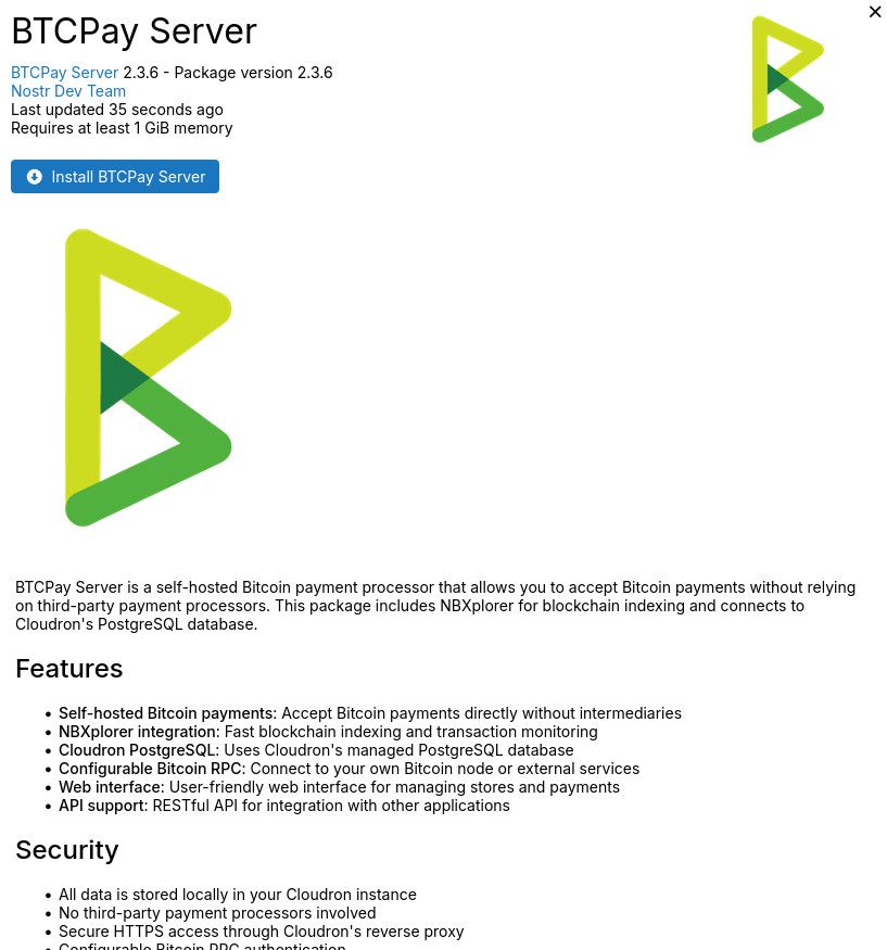

                    Also updated to v2.3.6

                      @nostrdev thank you for getting this done. Appreciate the time applied. Will test it out shortly.
