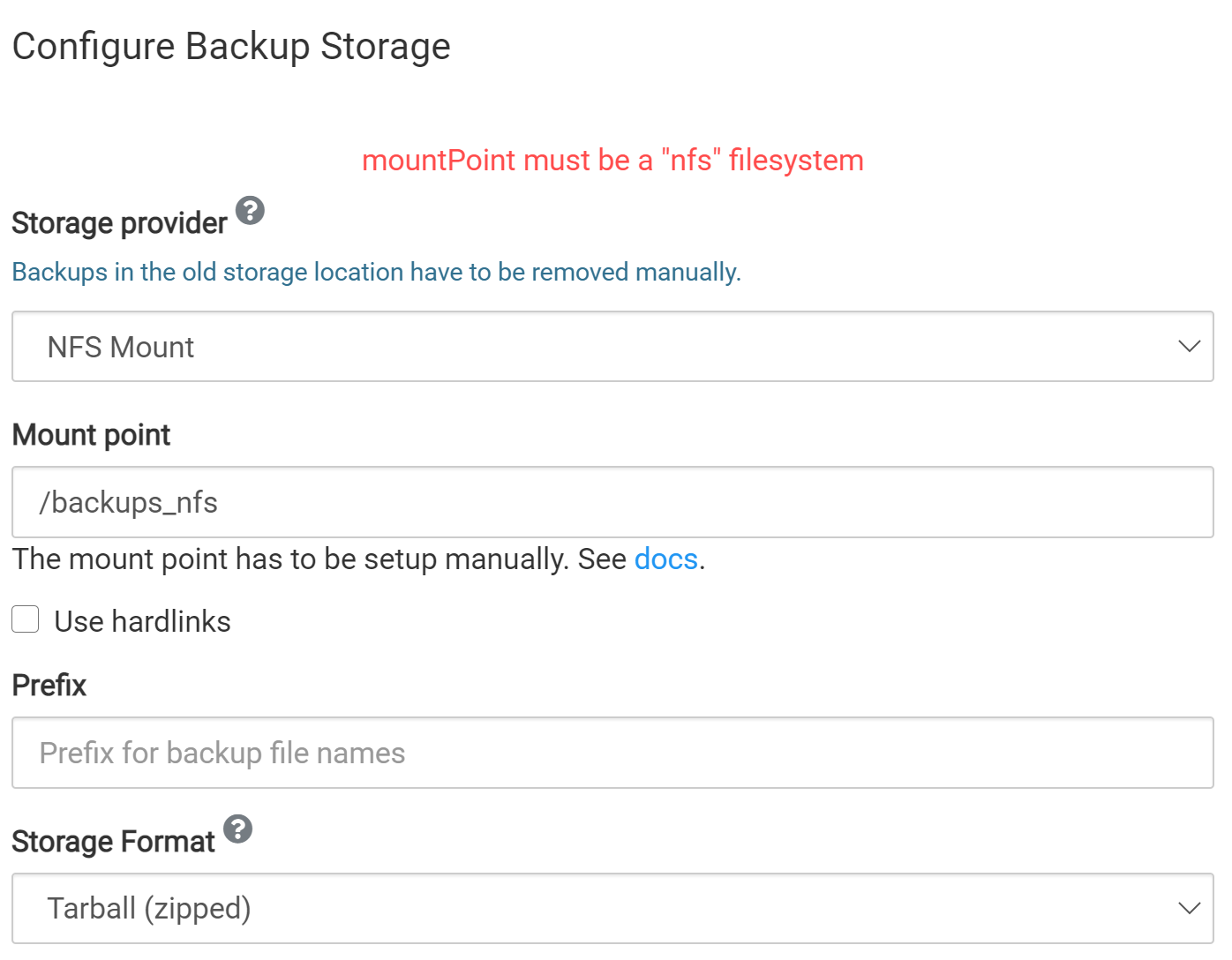

    I have a NFS drive from my NAS mounted via this command in the /etc/fstab
    (myserverIP):/mnt/array1/share /backups_nfs nfs rw,hard,tcp,rsize=8192,wsize=8192,timeo=14,x-systemd.automount 0 0
    Here is the output of cat /proc/mount showing its been mounted
    systemd-1 /backups_nfs autofs rw,relatime,fd=57,pgrp=1,timeout=0,minproto=5,maxproto= 5,direct,pipe_ino=16222 0 0
    I'm getting an error everytime I try to select "nfs" as the backup location in the cloudron backup gui. It says "mountpoint must be an nfs filesystem" It works fine if i put that same path in of "/backups_nfs" as local filesystem. It will even write the backups to the share that way but it won't delete any.
    Im at loss. Why is this showing as "autofs" and not NFS in cat /proc/mounts? Why won't cloudron delete old backups and why can't this mount as NFS.

        It looks like your mount point is actually /mnt/array1/share/backups_nfs and not what you have in your screenie

          @robi Unfortunately, I tried it that way as well, i get same error message. The mount point theoretically, is just the folder i've mounted the share to. the first half of that /mnt/array1/share is my shared folder.. the actual mount is just /backups_nfs. I tried both though just to make certain and i get same error. NFSStillNoGo.JPG
          nebulonN robiR 2 Replies Last reply
          • M Mastadamus
            @mastadamus this is actually a bug in the code. The mountpoint checker is based on /proc/mounts which in your case as you thankfully pasted, does not contain nfs as the type but some autofs not sure why we lost that information here.
            For reference, the code is at https://git.cloudron.io/cloudron/box/-/blob/master/src/storage/filesystem.js#L291

              @mastadamus there still seems to be an issue with that path because of the space after the 'share'.
              @nebulon good catch on the mount type too
                @Mastadamus if you like, you could enable remote SSH support temporarily for us and send a mail to support@cloudron.io with your dashboard domain, then I could check how we can fix the filesystem type detection.

                @nebulon From my reading, if you do the system.automount option in the fstab it makes it autofs. This may be wrong, but I read that in multiple locations.

                      @mastadamus my understanding is that autofs is meant for mounting on demand. I guess we have two options here: Cloudron can add a autofs provider and look specifically for "autofs" type. Alternately, you can just mount it as NFS in the /etc/fstab . I think if you do the latter, it will work.
                      Essentially, change your current autofs line to be instead like below (i.e remove x-systemd.automount) . That flag was added in the docs when you have server that requires domain lookup, iirc :
                      (myserverIP):/mnt/array1/share /backups_nfs nfs rw,hard,tcp,rsize=8192,wsize=8192,timeo=14 0 0
                      After that, remount it and mount -a output will show nfs instead.

                        @girish I did as you stated except I started completely over and created a new mount point named bu_nfs and then added the fstab entry. in proc/mounts i get the following now.
                        (myIP):/mnt/array1/share /bu_nfs nfs4 rw,relatime,vers=4.0,rsize=8192,wsi
                        yet when I put in /bu_nfs or /mnt/array1/share/bu_nfs inside cloudron gui, I get the same error message that it must be an NFS file system. Yet i can mount it as a local file system fine. It is showing nfs4 in proc/mounts though

                          @mastadamus said in NFS mount not working.:
                          Maybe because of the nfs4 above. Can you make it nfs?

                            @girish What is the command to force it nsf instead of nfs4?
                            something like this?
                            myIP:/mnt/array1/share /bu_nfs nfs nfsvers=3 rw,hard,tcp,rsize=8192,wsize=8192,timeo=14 0 0
                            i think i need to specify which version..

                              @mastadamus I meant like this (note that vers=4.0 i guess already means nfs4)
                              (myIP):/mnt/array1/share /bu_nfs nfs rw,relatime,vers=4.0,rsize=8192,wsi

                                @girish Yes that line was the output of my proc/mounts. my fstab command was exactly as you wrote. Its automatically selecting nfs4. I think to force it to select an older version of NFS like ver 3 or 2 i have to manually input a nfsvers= command or vers= command

                                    @mastadamus I think we want nfs4. Note that all we are trying to do here is to get the output of cat /proc/mounts to show nfs instead of autofs and nfs4.

                                      @girish ah im following you now. I have absolutely no idea how to make proc/mounts do that lol.

                                        @mastadamus what is the /proc/mounts output as it stands right now?

                                          This is the output of the proc/mounts
                                          192.x.x.x:/mnt/array1/share /bu_nfs nfs4 rw,relatime,vers=4.0,rsize=8192,wsi ze=8192,namlen=255,hard,proto=tcp,timeo=14,retrans=2,sec=sys,clientaddr=192.x. x.x,local_lock=none,addr=192.x.x.x 0 0 (note i replaced my IP's with 192.x.x.x. not that it really matters lol)
