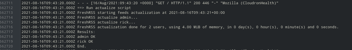

    @rmdes can you check the app logs to see if the cron job runs?
    You should see ==> Run actualize script in the logs every now and then.

      @rmdes Can you try systemctl restart box. This should resync the cron jobs. Let's see if that helps . If it does, that seems like a bug in the box code somewhere. The actualize script is run every minute it seems.

        @girish @nebulon all my FreshRSS apps stoppped running the actualize script on the 23th of August at the same time, same in all the log file
        2021-08-23T09:41:40.000Z - - - [23/Aug/2021:09:41:40 +0000] "GET / HTTP/1.1" 200 446 "-" "Mozilla (CloudronHealth)"
        2021-08-23T09:41:44.000Z FreshRSS actualize polbegov...
        2021-08-23T09:41:44.000Z FreshRSS actualization done for 2 users, using 10.00 MiB of memory, in 0 day(s), 0 hour(s), 0 minute(s) and 14 seconds.
        2021-08-23T09:41:44.000Z Results:
        2021-08-23T09:41:44.000Z euwatch OK
        2021-08-23T09:41:44.000Z polbegov OK
        2021-08-23T09:41:44.000Z End.

          @girish I have done it, let's see if the cron jobs reboot, thanks !!!
            rmdesR Offline
            rmdesR Offline
            rmdes
            @girish That solved the issue nicely !
            Aug 28 17:42:50 - - - [28/Aug/2021:15:42:50 +0000] "GET / HTTP/1.1" 200 446 "-" "Mozilla (CloudronHealth)"
            Aug 28 17:42:50 ==> Run actualize script
            Aug 28 17:42:50 FreshRSS starting feeds actualization at 2021-08-28T15:42:50+00:00
            Aug 28 17:42:50 FreshRSS actualize euwatch...
            Aug 28 17:42:50 FreshRSS actualize polbegov...
            I'm not seeing any error that might have caused this but happy to look elsewhere under your direction and export logs if necessary 🙂

              @rmdes the jobs are triggered by a scheduler run via nodejs cron and we have seen this getting stuck in the past. So far I don't think there were any pointers how to fix that unfortunately.

                    @nebulon Yeah it happened again for one on my FreshRSS container, no idea why, same solution applied and all is good now 🙂
