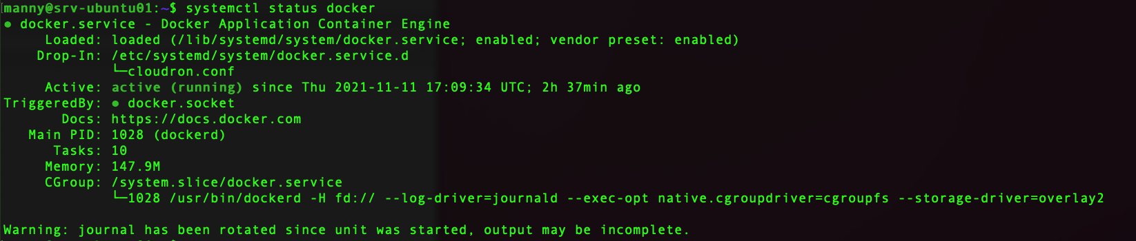

        @girish Docker Status: Screen Shot 2021-11-11 at 2.48.57 PM.png

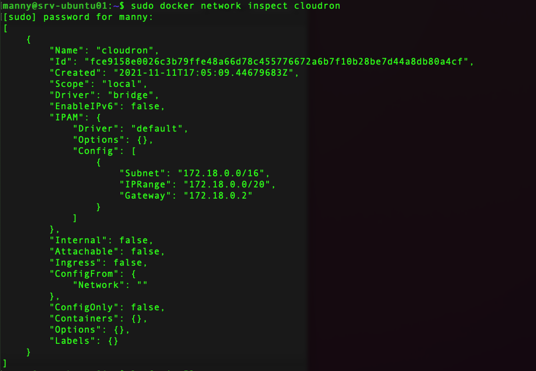

        Docker Network & port 53:

          @mannyc1701 docker seems OK. What is the lsof -i :53 output?

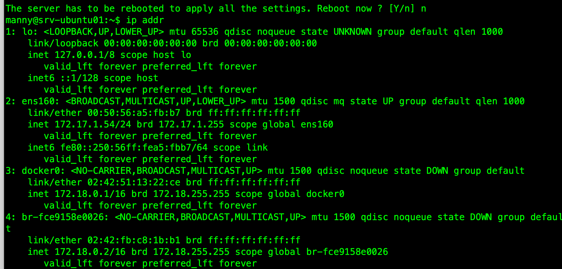

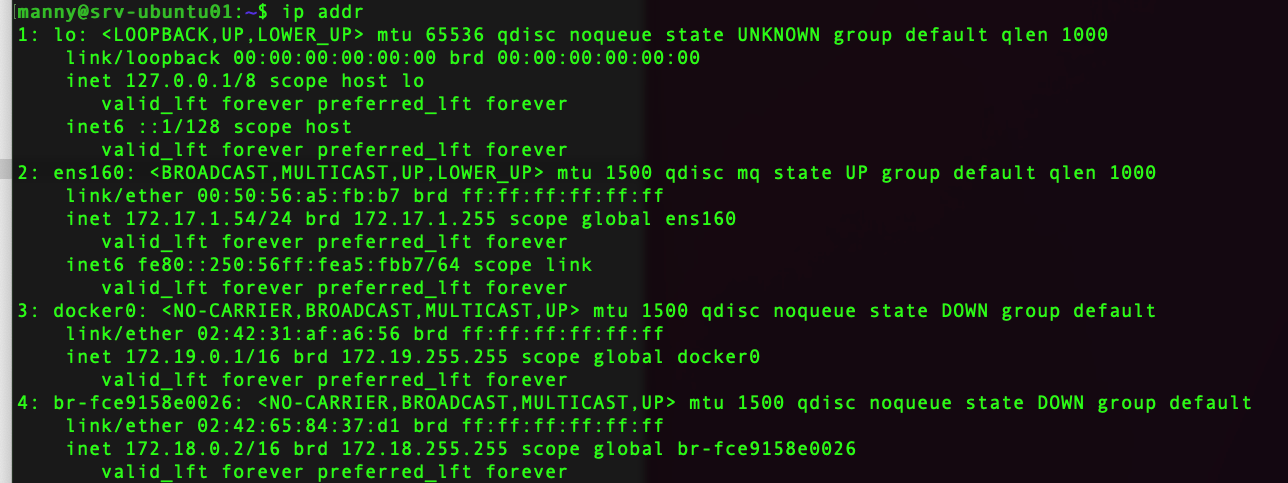

                      Prior to reboot after installation I ran ip addr output and could ping 172.18.0.1 & 172.18.0.2.
                      this is the output after restart.
                      docker ip changed to 172.19.0.1, I don't if that helps, it seems ip 172.18.0.1 is in use or configured and cannot be used but I can reach 172.18.0.2 without issue.
                        @mannyc1701 said in Install Cloudron 7.0.3 on Ubuntu 20.04.3 ESXi:
                        Thanks for hanging in there. The above is the core issue. Our code assumes the bridge gets the IP 172.18.0.1 . I am not sure why it gets it as 172.18.0.2 in ESXi . Maybe it was just a happy accident, but we had this assumption since forever.
