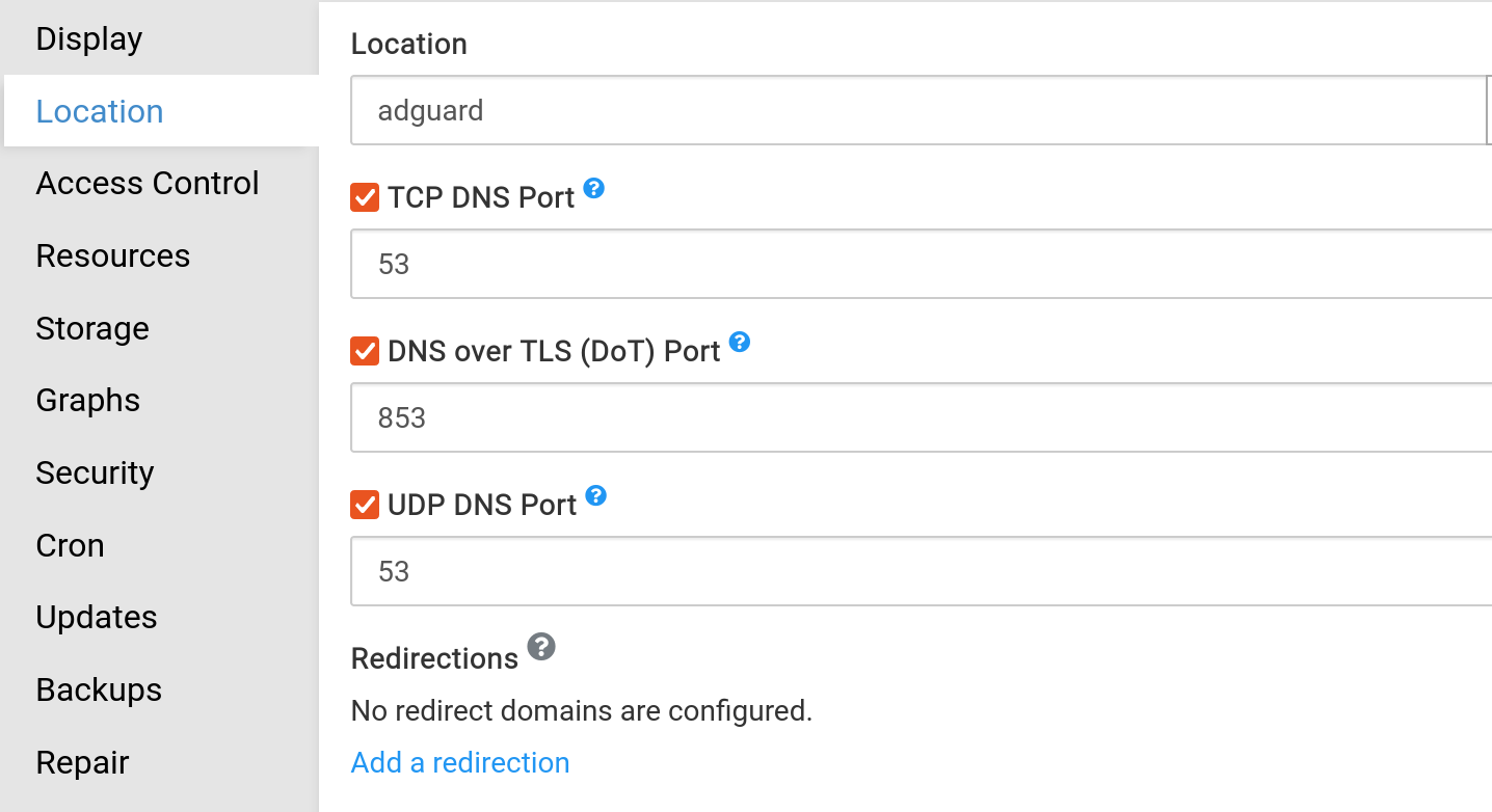

                  So, all I had to do was Settings -> Network & Internet -> Advanced -> Private DNS. There in the'Private DNS provider hostname, I just enter my AdGuard installation hostname like adguard.domain.com . That's pretty much it. Note that you cannot put an IP address here since Android requires the cert name and the hostname to match.
                  For the above to work:
                  • In Cloudron dashboard -> Adguard -> Location section. Do you see DNS over TLS (DoT) Port enabled ?
                  • If you are on a home sever, the firewall needs to port forward the above port (853 by default) to the Cloudron VM.
                  DanTheManD ei8fdbE 2 Replies Last reply

                        @girish said in Support for DoT (DNS-over-tls):
                        Aha! This is probably the reason it's not working. I wasn't aware of that setting. But now I do see it (and its enabled).
                        I'll forward that port in my firewall. Thanks @girish
