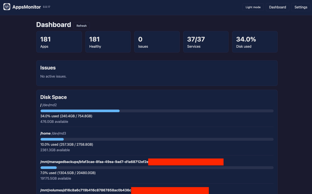

                                          Disk usage general :

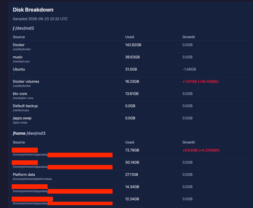

                                          Disk usage beakdown + growth / velocity checks :

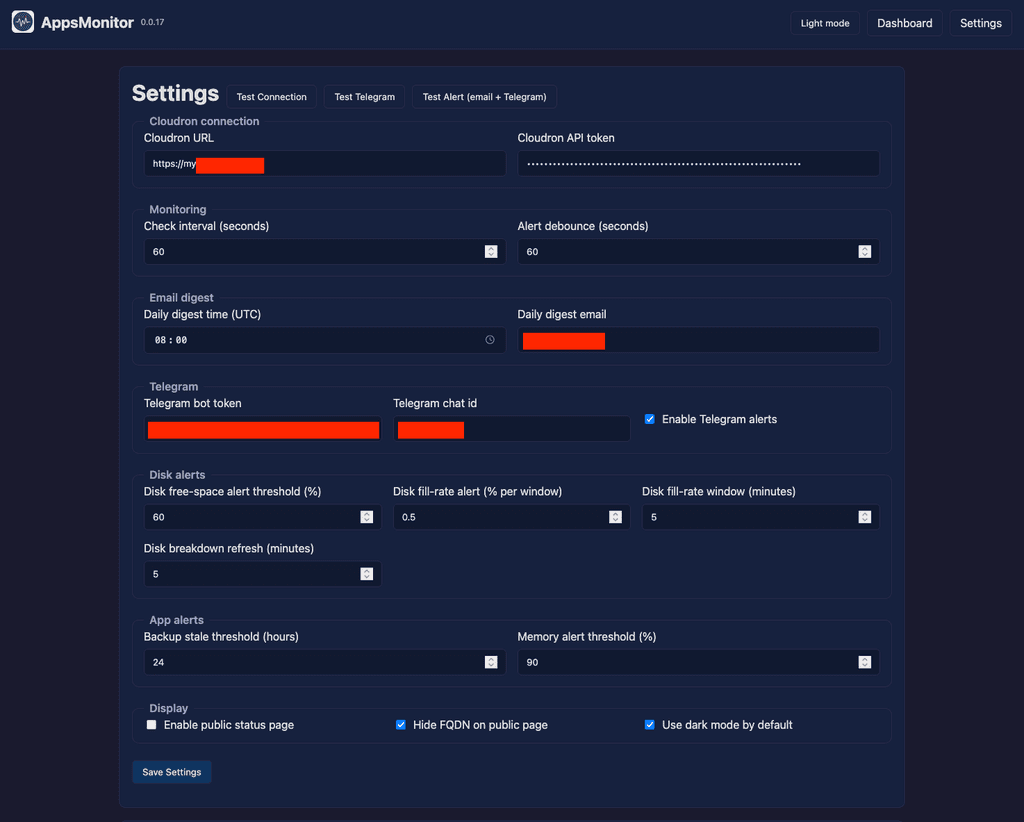

                                          Settings including alerting and disk usage report parameters :
                                          Note : settings shown are for testing. Setting frequency too fast can impact system performance.
