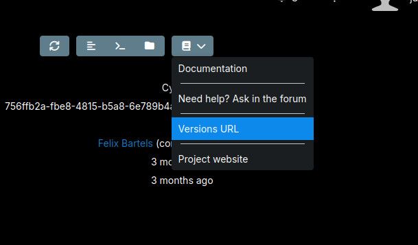

Quite possibly, but I can't see anywhere that I can actually check/ update the location of CloudronVersions.json
You have use the CLI tool .
cloudron update --versions-url <> --force. Is that what you are looking for? -
@jdaviescoates also, to check the location see the Help dropdown of the app. It's quite hidden.
@joseph aha, thanks! That is what I was looking for:
And yeah @fbartels mine was still https://git.9wd.eu/apps/cloudron-cypht/raw/branch/main/CloudronVersions.json which is now a 404.
