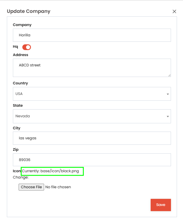

            Okay, here is the first one that buggs me.
            I just did a Cloudron setup https://horilla.cloudron.dev/ init the demo db. (login if you want to admin:admin)
            Company icons missing in media, sure makes sense. They do net get downloaded in the demo db init setup, I guess.
            Now I uploaded 3x other company logos.
            black, green and red.
            All 3x files exist, but get a 404.
            Why? πŸ˜„
            https://horilla.cloudron.dev/media/base/icon/black.png is 404 🀷

                @BrutalBirdie The problem is likely due to the media folder being owned by root, while the application server (typically running as a non-root user inside Cloudron) doesn't have read access.
                Can you confirm whether the Cloudron running user has the access for the same?
