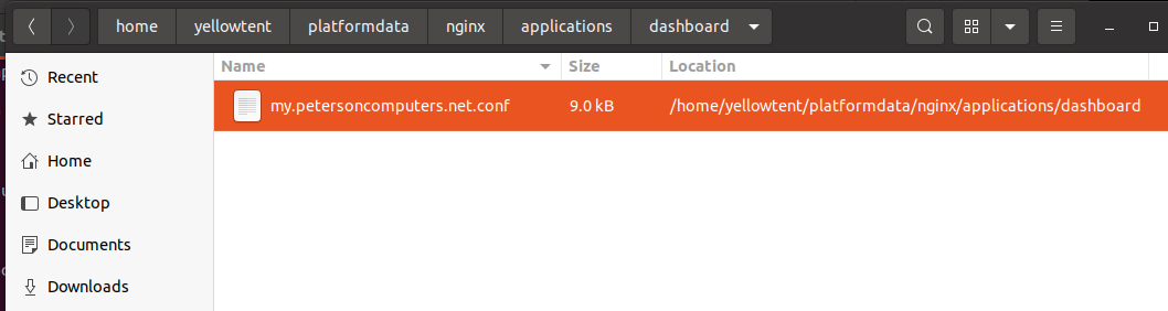

        For the record, I am able to locate the file on the OS -
        Although I do see the cert error, I am not entirely sure that's the only problem here. Granted yes I got the below error to check the yellowtent directory for logs.... but when doing so I am seeing issues with MySQL:

          Are you running Cloudron on a desktop ubuntu? This is not supported and will cause various side-effects.
          You might be right that there are other issues then. For the mysql issue, have you updated or changed the system mysql? Note that Cloudron needs specific versions of some dependencies and just updating ubuntu will also break often.
          If the cloudron-support script cannot open that nginx config file, can you check permissions of that?

            Also where exactly are you getting info that Ubuntu 20.04 is not supported? It's outlined in your docs that it is = https://docs.cloudron.io/guides/upgrade-ubuntu-20/
            Below are the permissions I see on the file -

              Ubuntu 20.04 is supported, I was more guessing from the screenshot of a desktop app, that the desktop flavor of Ubuntu 20.04 was installed and not the server edition. Things may work, but we do not test and support non-server versions.
              So the error above kinda makes no sense then:
              sed: can't read /home/yellowtent/platformdata/nginx/applications/dashboard/my..conf: No such file or directory
              Just to be sure, those two dots in my..conf is how it is printed or did you remove the actual domain between the dots?

                                    However I'm now hung again on the cert, and for the life of me can't figure out where to go on here to address that. Any thoughts? All the certs on my box are showing that it expires on 09/27/2024 so I'm totally lost on this one
                                    I should also mention that the directory that it points me to for assessing the situation also has no files listed for troubleshooting this problem:
                                    root@pcomp-webadmin:/home/yellowtent/platformdata/logs/tasks# ls | wc -l
                                      Actually on that domain, the cert looks fine to me from my browser. nginx appears fine also, however the box backend service is not working. Check the logs at /home/yellowtent/platformdata/logs/box.log
                                      mpeterson0418M 1 Reply Last reply
