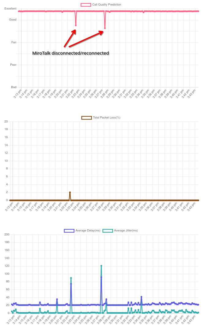

                #23
                Right so, I have an update on this. It seems indeed that the disconnect have to do with the quality of the connectivity. I went away from home for a month and had much lesser issue in that other place (in fact none).
                At home we have one router and two repeaters. It seems like depending on a how the laptop connects to the broadband impacts how frequently I get disconnections (i.e. whether it connects to a repeater / to the main router / over wifi 5 / over wifi 6E). I also get frequent disconnections when behind a VPN or over 4g/5g.
                So while in optimum situations with very direct wifi the issue does not occur and MiroTalk functions correctly, it's still, I believe, a problem with how the app is optimized with regards to packet losses because I none of these issues using Jitsi, Teams, Zoom or Meet.
                When I try my connection in any scenarios (at home connected to any device, or on 4g/5g) on here: https://test.vsee.com/network/index.html, it shows always between Good and Excellent.

                      @mirotalk-57bab571 I've been able to capture connection quality issues as I got disconnections on MiroTalk using https://test.vsee.com/network/index.html. The two drop in connections quality coincided with the disconnections/reconnections events in MiroTalk, which somewhat explain why those events happen randomly and support the idea it has to do with the quality / reliability of my connection (see below).
                      But there is something about MiroTalk that makes it particularly sensitive to it as does not happen with any other apps.

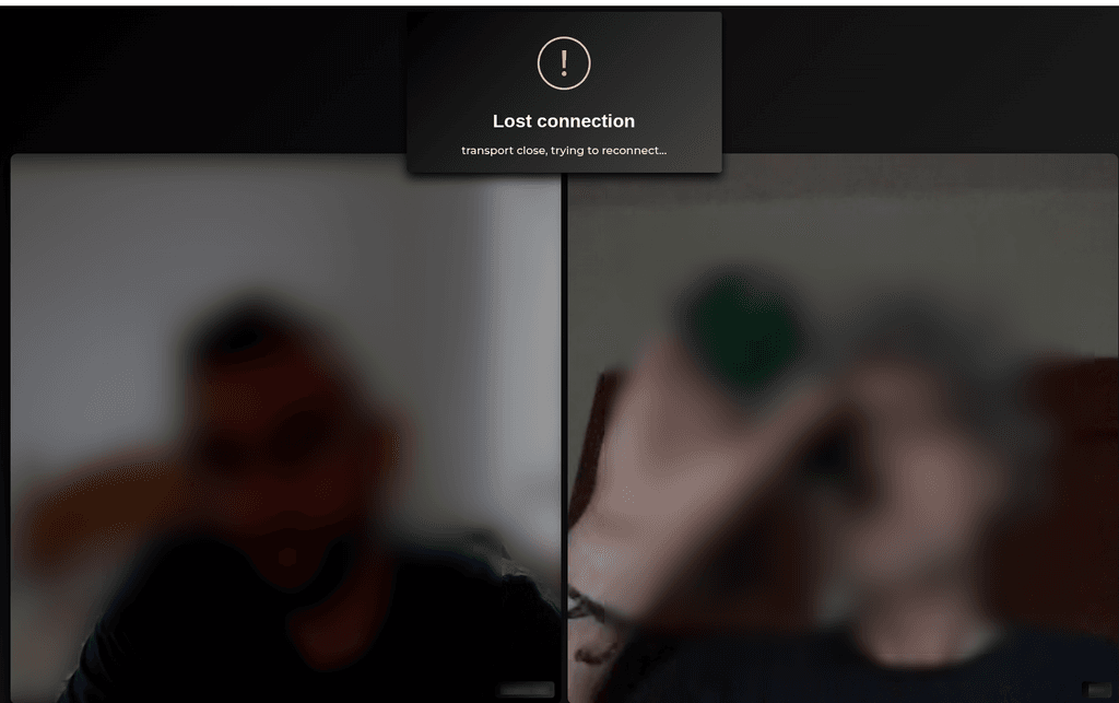

                                  Hello @mirotalk-57bab571 . So things are different since the updated version. In my first first meeting I had no disconnections so I had great hopes...which sadly got crushed in my second meeting where I had several disconnections. The behavior when the disconnections occur has changed.
                                  • Before, when the connection would drop, this message would appear briefly Lost Connection (Transport Closed), then the page would reload automatically immediately and I would get reconnected to the meeting with both camera and mic off. When turning on my camera back on, the background settings would be lost (say if I have blur before, then on reconnection I would have a clear background).
                                  • Since the new package, when the connection drops I see this (slightly different message):
                                  ...and that page lasts a bit longer before refreshing and reconnecting (on a couple of occasion I saw a count down appearing on the massage). Then it sometimes takes a couple of refresh before I actually get reconnected properly.
                                  On one occasion I could not reconnect and the app itself became unresponsive. It was show as running on the Cloudron dashboard, when when clicking on it I had the Cloudron error page saying the app was unresponsive. I had to restart the app from the app settings on Cloudron.
                                  On another occasion, right at the start when joining a meeting, I got disconnected right away and on reconnection my external webcam was not recognised anymore and I had to use my laptop one. This had never happened before.
                                  So while clearly something has changed in the way connections are handled, currently the situation/UX has become, I'm afraid, a little worse, but I do not loose hope that this is just a sign of work having started to take place and it'll only get better from here to reach perfection 🙂 .
