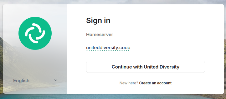

                    BTW, I just noticed that in my Cloudron Dashboard is says "login with dedicated account":
                    But it's actually using OIDC:
                    What's going on there? 🤷
                    Either way, I'm hoping we can have MAS soon and that that will make Element X work with my instance 🤞
