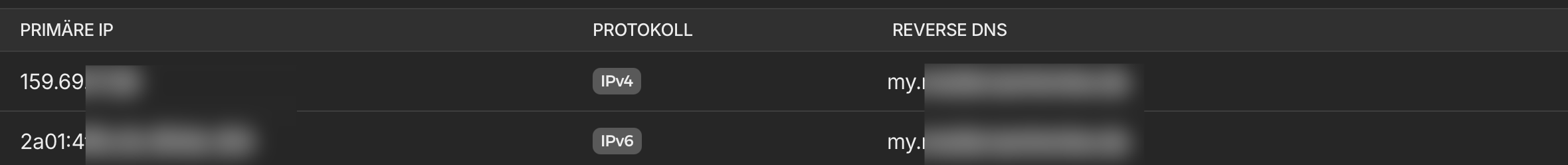

        mh..... still get the same error...
        PTR setting Hetzner:

          That fixed it for me.
          Although I also did this too
          1. in Network: under IPv6 section I chose Public IP (was previously Disabled)
          2. in Domains -> hit Sync DNS (for good measure)
          Perhaps they were all needed.
