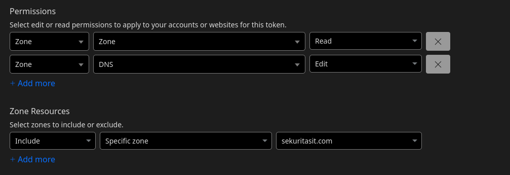

    cloudflare zone token set up as per instructions:
