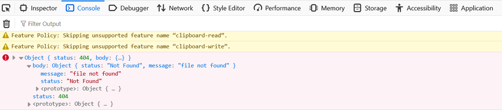

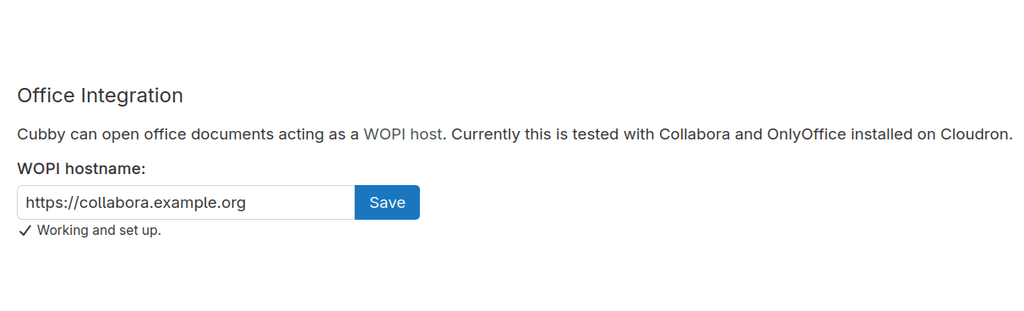

    I am running Cubby and Collabora on the same Cloudron server and have set the collabora domain as the "WOPI hostname" in Cubby's settings. Collabora is also configured to allow connections from the Cubby domain. In Cubby, under WOPI hostname, I get the message " Working and set up."
    However I get a blank page when opening a word document in Cubby. Additionally, if I open a pdf in Cubby, the document is downloaded by my browser (Firefox) instead of being previewed. Any pointers?
      Do you see any errors in the blank page browser console/webinspector to give any hints? Also check both cubby and collabora server side logs so we have hopefully something to work with.
      For PDFs, cubby would use the browser's pdf viewer in an iframe, if this is what you see, that is expected.

        The only error that I see is in the browser console, nothing useful I could find in the Cubby and Collabora logs.
        I have reverted back to using Nextcloud which is working fine with the Collabora plugin.
          Hm the error indicates, that the file could not be found in cubby. Did the file have some special unicode characters maybe?

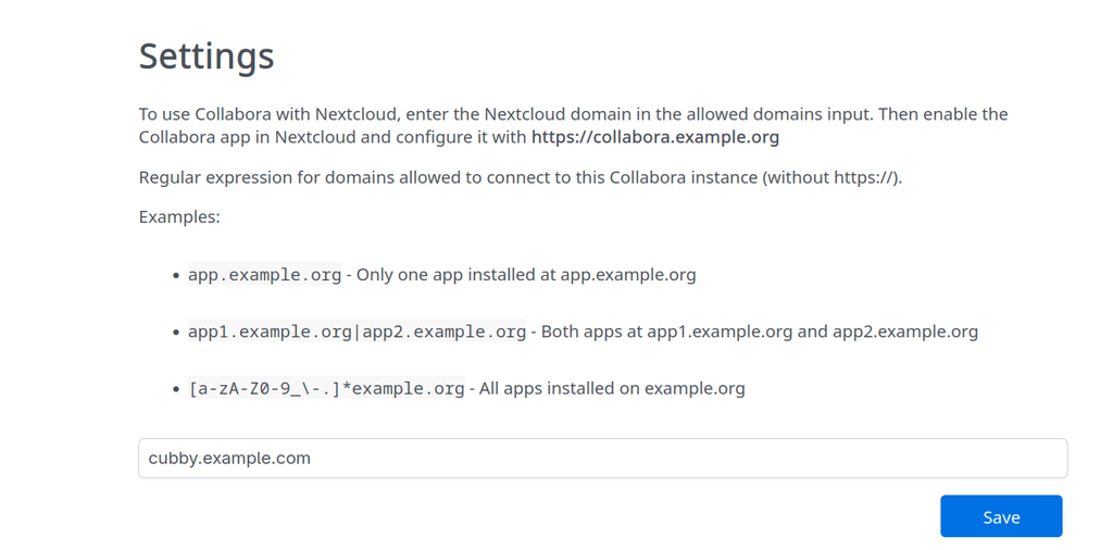

                        @nebulon User error confirmed after 15 minutes of testing. Note: adding another domain to Collabora requires the format [a-zA-Z0-9_\-.]*domain1.org|[a-zA-Z0-9_\-.]*domain2.org plus a restart. We should probably update the settings page with this info.
                          The required restart is a good hint which the UI should give. We will add this.
                            After debugging this, turns out the internal app restart was broken, hence it required a whole app restart. This is fixed with next package version.

                              I think I may have stumbled upon the issue on my end. I have Collabora running behind Cloudflare's proxy.
                              When attempting to open files with spaces in their filenames via Collabora, Cubby fails to load the document and returns a 404 Not Found in the browser console. This appears to be caused by double-encoding of the file path in the WOPI handshake.
                              Steps to Reproduce:
                              1. Upload a file with a space in the name (e.g., Audit Record 2026.xlsx) to Cubby.
                              2. Attempt to open the file with the Collabora integration.
                              3. The editor opens but remains blank.
                              Observed Behavior:
                              The browser console shows a 404 error for the file path:
                              api/v1/files?path=%2Fhome%2F2025-11-19%2520Work%2520Orders.xlsx
                              The space character (%20) has been double-encoded into %2520.
                              Expected Behavior:
                              The path should be decoded correctly by the server/proxy to locate the file on disk.
                              Workaround Found:
                              Renaming the file to remove spaces (e.g., Audit_Record_2026.xlsx) resolves the issue and the file opens successfully.
                              Possible Solution:
                              Cloudron team can fix this by changing how the app handles the WOPI access_token or by ensuring the path is decoded once more before the final request.
                                What if the filename has 2 spaces? Does this become 4 spaces in encoding? How is cubby supposed to know when to double decode? Do you have link for this cloudflare encoding behavior?
