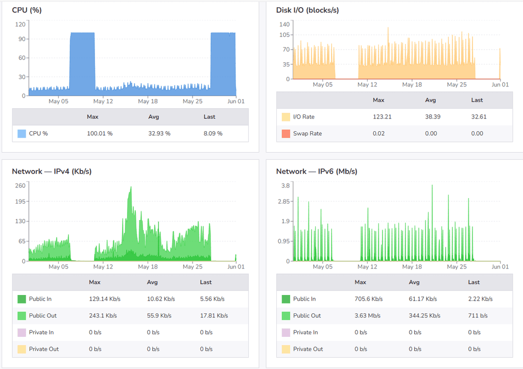

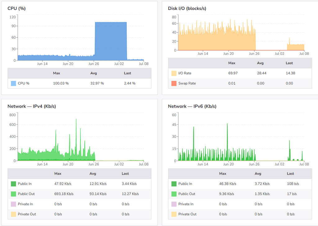

            The following pattern occurs often: the server becomes completely unresponsive, I check the cloud dashboard and the server is using 100% CPU for something (I've never figured out what), so I reboot it and it goes back to normal. This cycle has repeated for over a year; I recall that I reported it before, but it's still an issue. Here's what it looked like in May:
            I did this again on July 4th, but this time it looks like it didn't come back ok:
            I have plenty of disk left, > 50GB

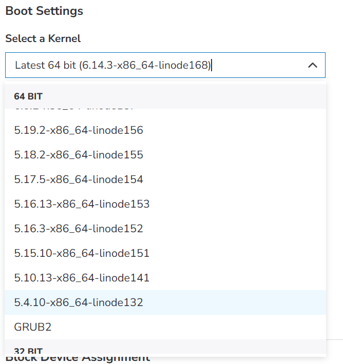

                      We were able to inspect the server today morning and after some debugging it turns out the system was booting a kernel which doesn't have memory cgroups enabled. In fact that kernel wasn't even installed on the system but apparently linode provides a way to boot the system with other kernels. This seems what caused the issues that the containers couldn't start anymore.

                        Wow that's crazy. Yeah, it looks like the kernel was set to "latest" so maybe it was autoupdating? I'm switching back down to 5.4.10 which is the oldest allowed...

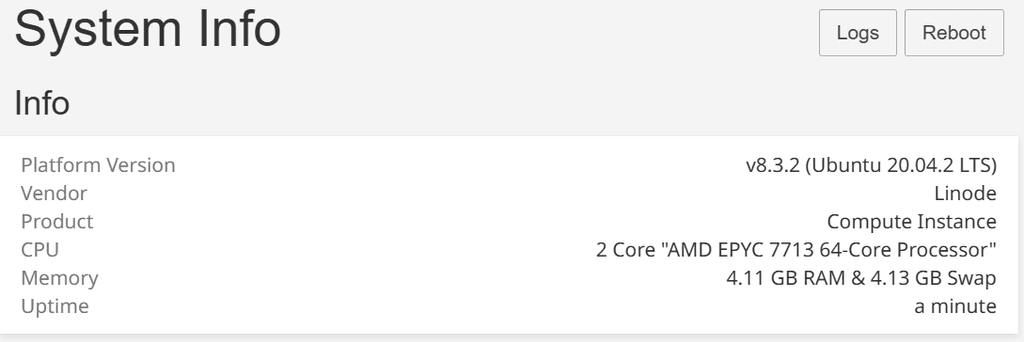

                          Maybe it would be worth putting the kernel version in the info section?

                            Any advice which latest kernel version I should be using? There are many options...

                                So maybe the correct option is to use the "Direct Disk" option that boots the kernel installed on the disk to allow the OS updates to manage the kernel version. This should head off any future issues and I won't have to coordinate when I upgrade to 22.04 and 24.04.
                                See: https://techdocs.akamai.com/cloud-computing/docs/manage-the-kernel-on-a-compute-instance#view-and-modify-the-kernel-in-cloud-manager

                                  Ok if I switch it to "Direct disk" it fails to boot but "GRUB (Legacy)" kernel option seems to boot fine. 🤷
