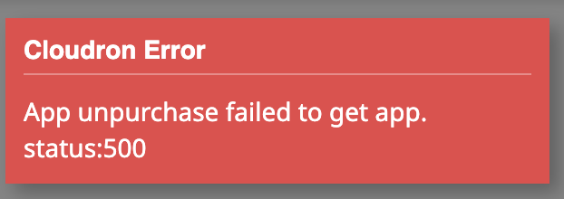

      Odd, similar thing, I just tried to uninstall docmost:

        Yes, I got that when I tried the CLI cloudron uninstall -app xxxx
        I got it uninstalled via the dashboard
        But now cannot install a new build.
        cloudron list is working so the CLI is not broken.

          @timconsidine
          cloudron uninstall -app 06e30ca6-89b9-4645-8319-b099beaffe3a
          error: unknown option '-app'
          CLI won't work for me at all, only listing the apps. Uninstall via the GUI gave me that error

                @timconsidine Uninstall with the GUI too, but CLI still broken for me
                  @andreasdueren oh no !
                  I did a server reboot but I'm far from convinced that made any difference as the error continued for some time after.
                  I did do cloudron uninstall --app xxx multiple times repetitively.
                  I also tried cloudron cancel --app xxx
                  Maybe that cleared a hanging task.
                  Other than that, I can't explain what got it working again, sorry.

                    I checked our appstore logs and it seems OK.. Maybe there was some issue reaching the appstore? Our appstore is on DigitalOcean which didn't have downtime yesterday (afaict).
                    Back in the day, we had grand ideas to allow people to buy apps (like in smartphones) etc . This is why when you install an app it goes into the appstore with a "purchase" and uninstall results in an "unpurchase". In Cloudron 9, we have removed all this since it's all unused and just making empty calls to the appstore.
