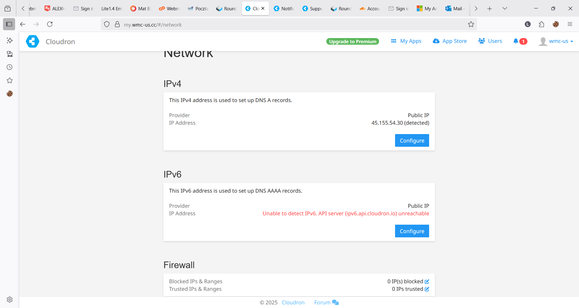

    Hello all
    I tried to install a new cloudron server and the ipv6 is not been detected from the cloudron even when i have put the dns with the AAAA name on my cloudflare..
    What can i do to alter this and make it work?

      I also tried to ping it and it did not work
      @joseph @girish please check the is a problem.
