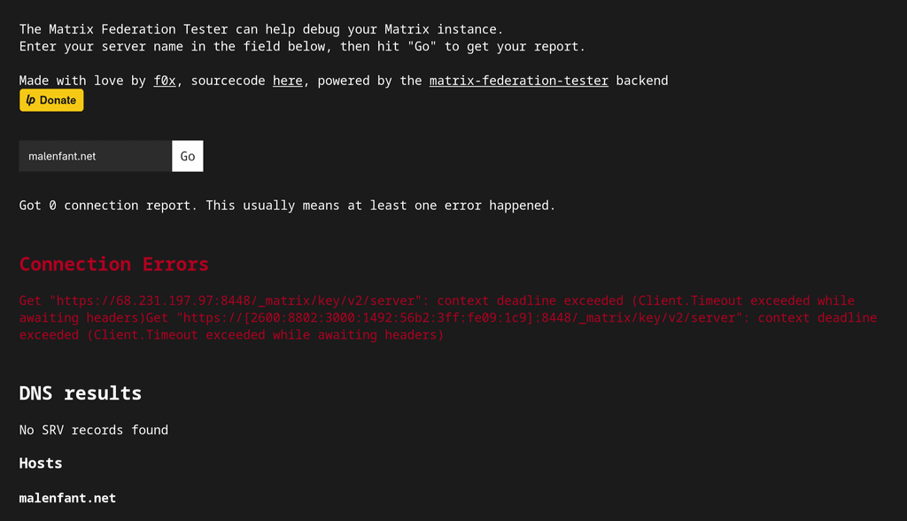

    I have the synapse app installed and I ended up having to port forward port 8448 to port 443 on my firewall in order to get federation testing to pass.
    Otherwise this error would be returned:
    Connection Errors
    Get "https://xx.xx.xx.xx:8448/_matrix/key/v2/server": context deadline exceeded (Client.Timeout exceeded while awaiting headers)Get "https://[2600:8802:3000:1492:56b2:3ff:fe09:1c9]:8448/_matrix/key/v2/server": context deadline exceeded (Client.Timeout exceeded while awaiting headers)
    I have the well known location setup up on the bare domain with port 443 but somehow this is not enough to get the server to pass the federation test.
    I don't see any mention of the port forwarding requirement in the docs, although it does mention that the app uses 443 for both user and server communications.
    Did I do something wrong in my setup or should this be maybe added to the documentation somewhere?

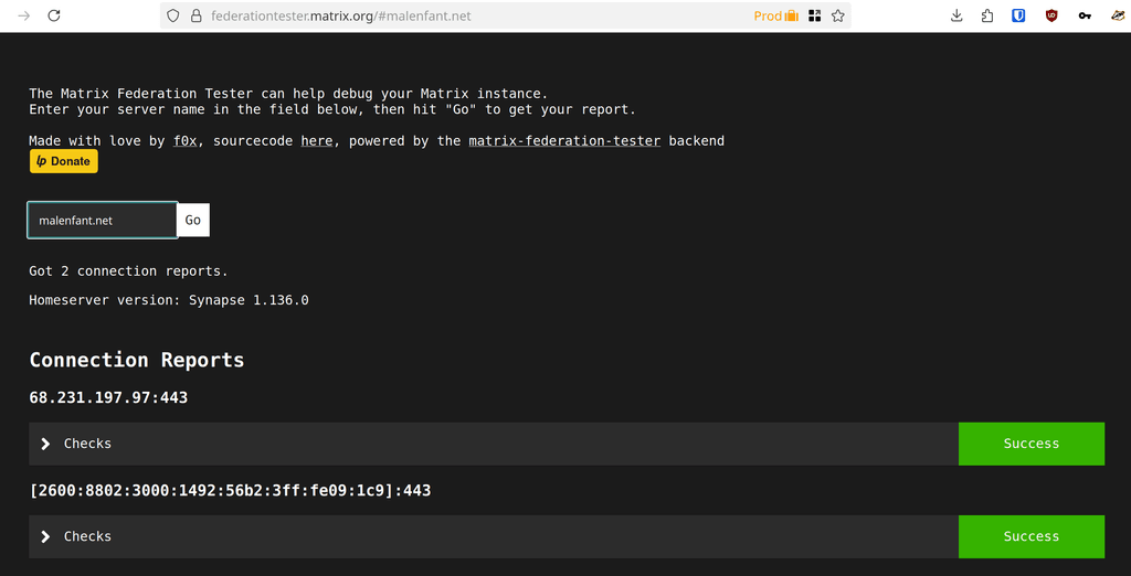

            But https://federationtester.matrix.org/#malenfant.net correctly recognizes federation. Is this with your fix?
            DidierMalenfantD 1 Reply Last reply

              Yeah. If I don't forward 8448 then the tester returns the error I put in the original post.
              Clouflare proxying is off for both matrix.malenfant.net and malenfant.net in my case.
              Does anyone know if the federation tester actually reads the well-known server info as part of the test?

                  This is where the results in my original post surprised me. If you look at the error log I got from the federation tester it looks like is does test for port 8448 and ignores the setting I have in the .well-known file which should point it to port 443.
                  Once I forward 8448 to 443 the federation testers returns no errors.
                  So my question was, does the tester ignore the well known file or did I set something up incorrectly when I seup the app? Basically do other people get the same error with the tester when using a fresh install of the app with the .well-known file correctly setup.

                          As I mentioned above I am checking malenfant.net with the checker and not matrix.malenfant.net.
                          The reason my domain currently works with the checker is because I have port 8448 forwarded to 443 on my firewall in front of the server.
                          If I remove the forwarding and run the checker I get the error I mentioned in my first post:
                          Connection Errors
                          Get "https://[xxx:xxx:xxx:xxx:xxx:xxx]:8448/_matrix/key/v2/server": context deadline exceeded (Client.Timeout exceeded while awaiting headers)
                          which would seem to indicate that the tester does NOT read the well-known file and indeed tries to check 8448.
