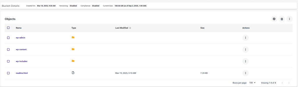

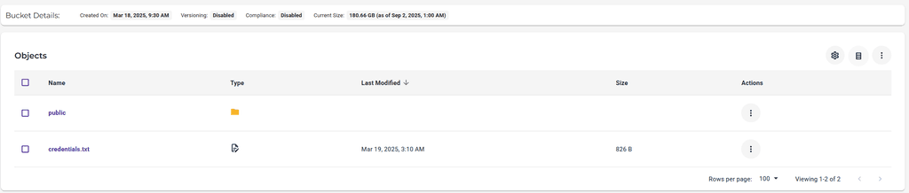

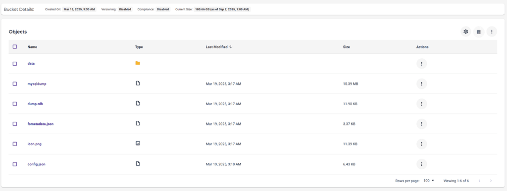

    I have a couple of wordpress (developer) apps running on cloudron
    On checking the contents of the automated backups they are missing key files like wp-config.php
    Is there a reason why it only backs up the data folder and a mysqldump - is this a plugin that is installed that needs to be used to restore?
    Screenshot 2025-09-02 173103.png Screenshot 2025-09-02 173049.png Screenshot 2025-09-02 173029.png
      @jamie.mckenzie that does not seem correct. There must be a wp-config.php inside data .
