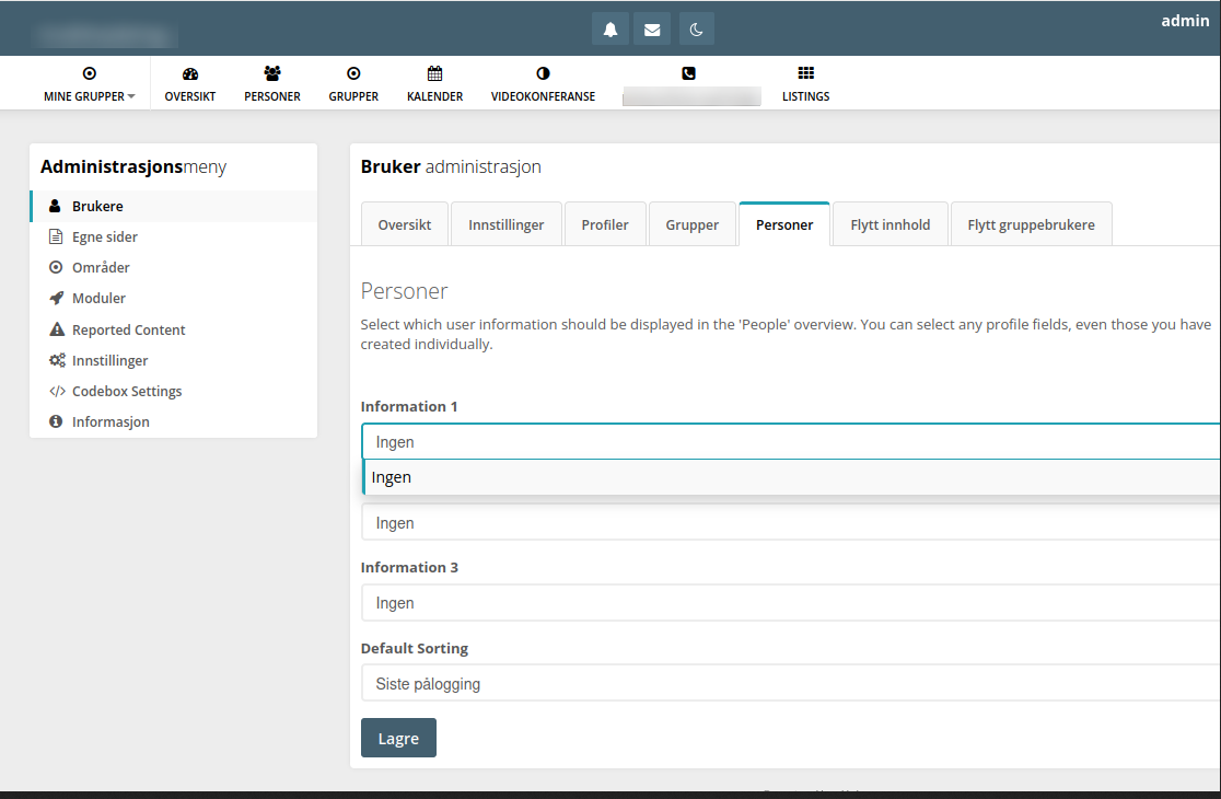

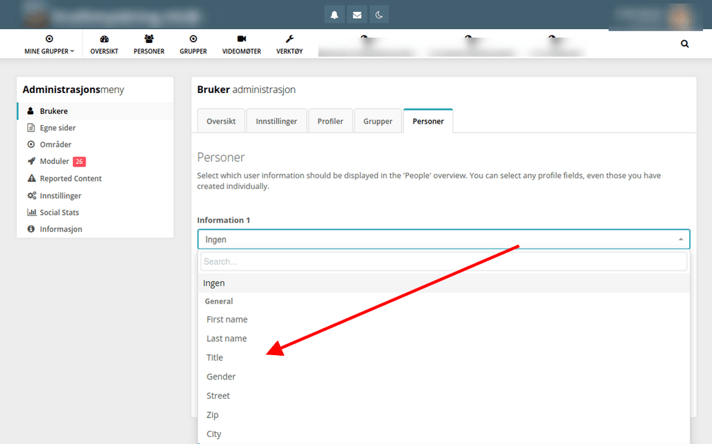

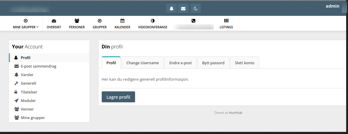

          I'll give it a shot. EDIT: Yep, something is wrong. I used this a few months ago and had tons of profile options. This one gives no options.
          Trying to add profile tags with the auto-complete doesn't work.
          This screen looks like there should be Information available to choose... but there is nothing.

          Let me add that on the very first attempt on this new install there was a brief moment after the Install page when a list of mysql db tables and info were shown and there was a yellow ! indicating a problem with the unicode encoding... but I didn't get a screen shot and subsequent installs to try to get that brief window haven't worked, it goes by to quick. This is a screenshot just before the list of db info:
          S 1 Reply Last reply
            The issue is somewhere in the first startup.
            It tries to load the demo data but does not install any module's or loads the demo data.
            Already on it to figure out why this is not happening.
