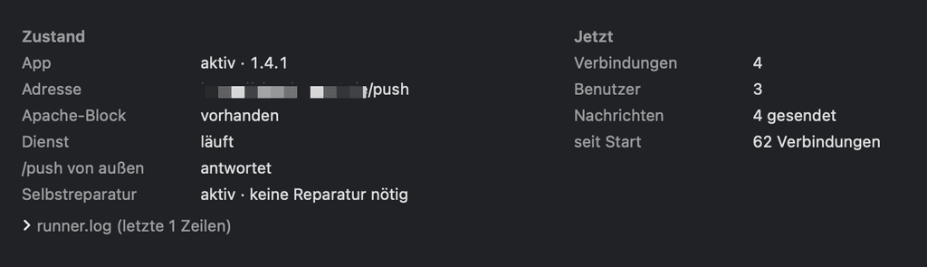

                      I think I got Nextcloud Client Push (notify_push) working persistently with the current Cloudron Nextcloud package.
                      Tested with:
                      • Cloudron Nextcloud package 5.8.5
                      • Nextcloud 34.0.2
                      • notify_push 1.3.5
                      This uses only /app/data; it does not modify read-only /app/code or /etc. I verified it across a full Cloudron app restart.

                      I also confirmed that both, my Hermes and the official Nextcloud sync client connected and authenticated to the WebSocket after the restart.
