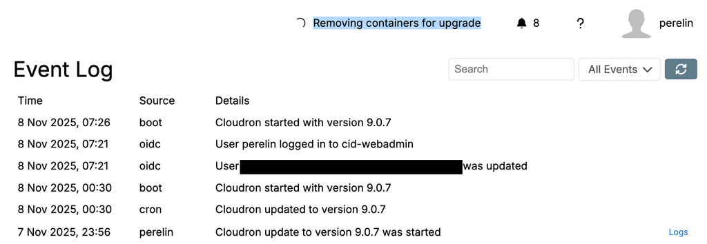

    Hi!
    Yesterday the update notification popped up for me and I thought: why not do a major upgrade on a Friday afternoon, what could possible go wrong 🙂
    Joke aside:
    The update seemed to progress well. Server restarted and event log shows 9.0.7 as successful.

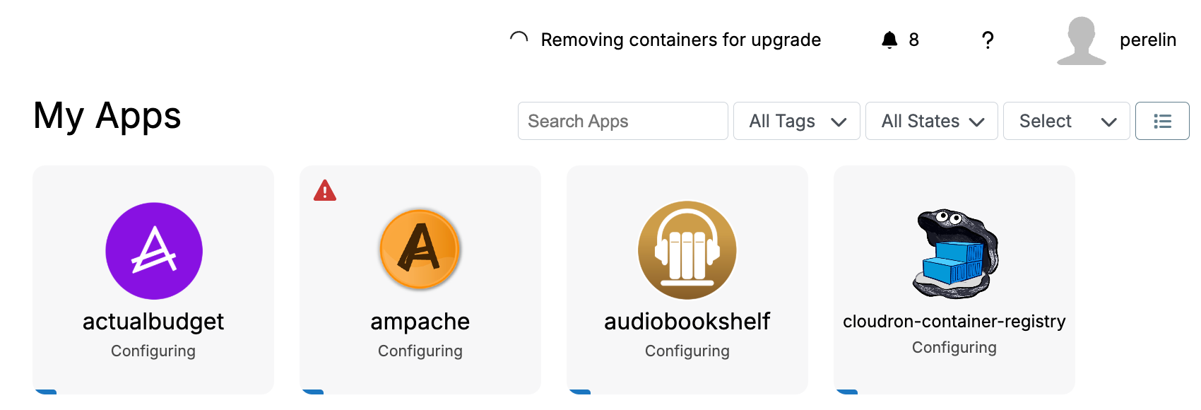

    But none of the apps work. Every single one shows "Configuring" in the app overview. The individual logs show nothing out of the ordinary and restarting individual apps does nothing.
    Also in the main app overview Cloudron shows the notification "Removing containers for upgrade"
    Tried rebooting the server already twice.

      How can I go about debugging this?
