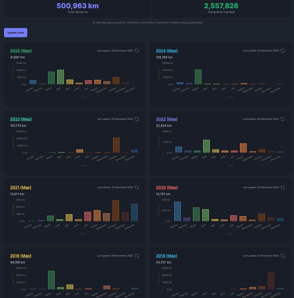

                      update: the amount of gpx files I tried to load was either too much or simply didn't worked out. Together with ChatGPT I was able to consolidate (multiple-)day files to monthly files, kml files to gpx and when you max to 100.000 datapoint per gpx file (about 11MB) I was able to upload and process them via GUI.
                      The result is AMAZING, this Dawarich app is absolutely great for people, like me, who always has a tracker on his smartphone. It's bizarre to see all your travels, vacations, flights etc etc.
                      Next step: integrate Immich.
                      @nebulon thanks for your time and effort to publish this app, very happy with it! 😀
                      The stats are also nice:
                      aa4f096f-c0c1-44b5-a998-394d9a59308a-Scherm­afbeelding 2025-11-20 om 15.42.33.jpg

                        @imc67 What? Almost half the distance to the moon in 2023?

                          #21
                          @luckow said in GPX file upload error:
                          Haha that’s impossible, I did a double check. I was in October on a car trip to Bavaria and somehow GPS was swapping many times between my home (NL) and location there, maybe because of bad GPS reception and VPN? I’ll have to manually correct them because this is nonsense of course.
