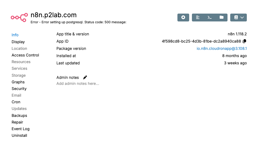

    I have two apps (n8n, mealie) that seem to have failed updating and display the error "Error - Error setting up postgresql. Status code: 500 message:"

        Hi @james !
        So, I cant manually trigger the update, the option is disabled. The app shows "error" in the overview.

        • perelinP Offline
          perelinP Offline
          perelin
          Ah: all other apps are fine btw.
          J 1 Reply Last reply
          • perelinP perelin
            @perelin have you already tried App -> Repair -> Try task again?
              Hello @perelin
              If still erroring.
              Let's try giving the N8N app and the PostgreSQL service more memory and try again.
              • perelinP Offline
                perelinP Offline
                perelin
                @joseph I just tried "App -> Repair -> Try task again" ... and it fixed both apps. ... Is now a good time to feel stupid? Asking for a friend...
