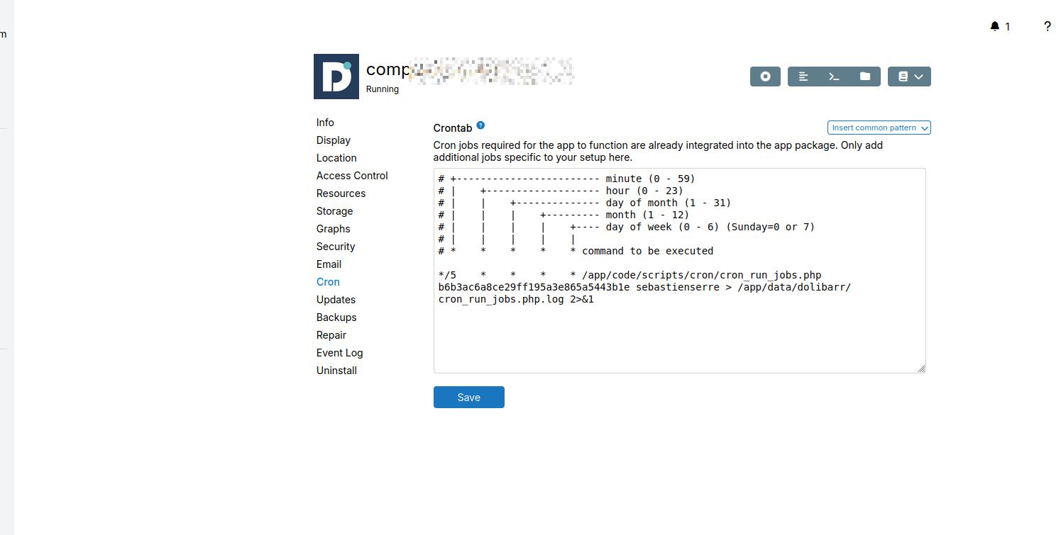

    Hello,
    I've set a cron task from the app (Dolibarr) panel:
    text alternatif
    I assume this task is run as root? (or not www-data user)
    Am I right ?
    If I need to change the user, do you suggest to edit the crontab from the web terminal ?
    crontab -e ?
    Thanks

        Hello @james
        I have an recurrent invoice created each 28th of the month and yesterday, it has not been created (first 28th after migrating to Cloudron).
        So I thought the Cron task was not run.
        i've added it on the Cron tab from the panel but the pdf generated by Dolibarr was owned by root user.
          @sebastienserre yes, cron commands are run as root. To run as a specific user, use sudo or gosu .
          gosu www-data:www-data /usr/bin/php /app/code/protected/yii cron/run
          OR
          sudo -E -u www-data php /app/code/upload/api/cron.php

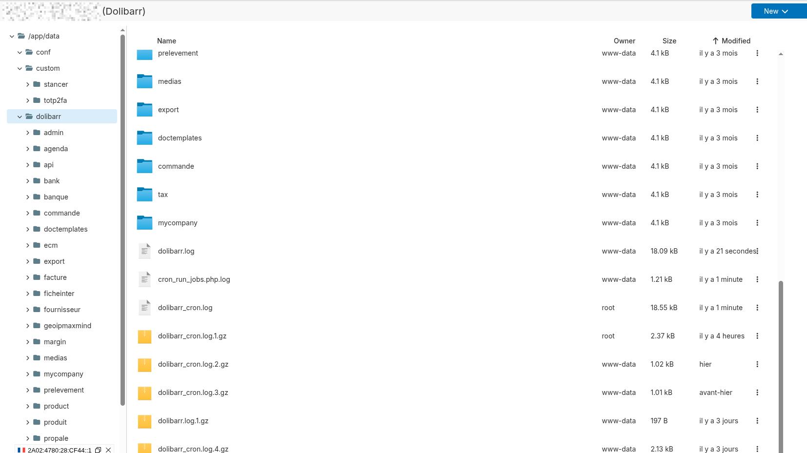

                Hello,
                Today, scheduled invoices haven't been created due to a permission error on the folder storing them in /app/data/dolibarr/facture/FA2604-0802
                Also, I have set the cron job to run with ww-data but it still rotates the log on root user:
                text alternatif
                text alternatif
                • jamesJ Online
                  jamesJ Online
                  Hello @sebastienserre
                  The custom cron runner was reworked and should work by default now without adding a specific cron job in the Cloudron Dashboard.
                  See: https://forum.cloudron.io/topic/15337/php-fatal-error-call-to-undefined-method-fetch_all-.
                  Can you please try it and report back if that works?
