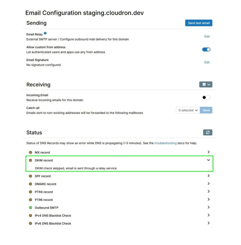

    When external SMTP relay is configured Cloudron still signs all outgoing mail with DKIM, but the UI hides the DNS entry it wants.
    Without the matching entry some mail servers then reject the mail because of the DKIM failure.
    Please either:
    • Do not sign the mail when using external relay to send mail
    • Expose the expected DKIM DNS entry to the end user so that they can configure it
    The half-way house does not work.
    As a workaround I disabled external relay to reveal the DNS entry, created the DNS entry, and then added the SMTP relay back again.
      Hello @caspear
      Thanks for reporting this.
      I could reproduce the behaviour:
        Hello @caspear
        I have looked a little more into this.
        When using a mail relay, DKIM and everything that is marked as skipped should be handled by the upstream relay server.
        You have stated:
        How did you validate this?

          Send an email through the Cloudron and look at the mail headers in the mail you end up with.
          It will include DKIM signature from Cloudron, which fails to validate if the DNS entry is missing.
          DMARC reports will also list it as an issue, if you have that configured.
