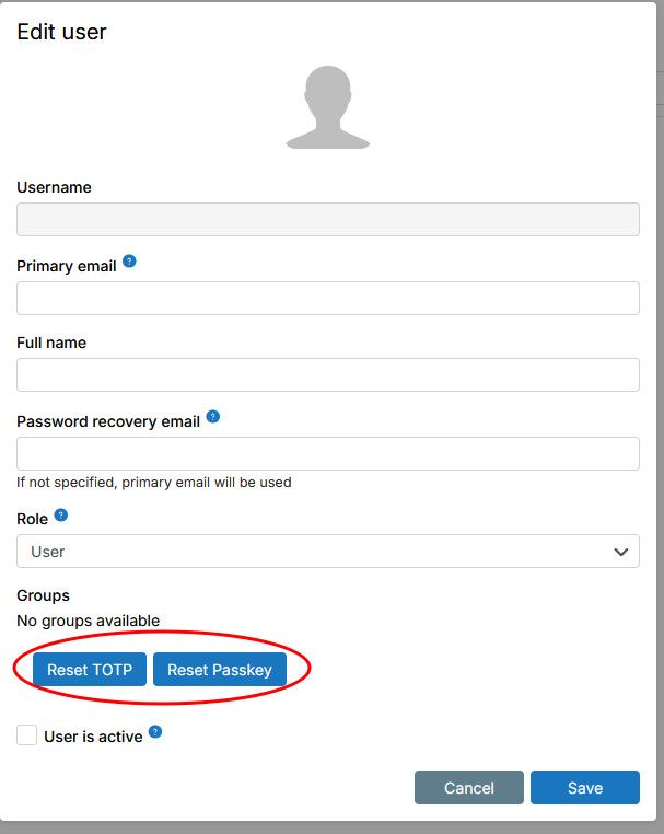

                      This would have been a lot faster, less complicated if an admin user had the possibility to reset TOTP/Passkey for other users.
                      Could this be made as a feature request?
                      Something like the following would be great
