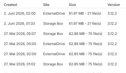

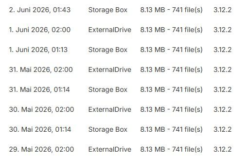

        Thanks. Let me add some context:
        It is about firefly-iii app. There are 2 of them: firefly-iii-green app and firefly-iii-red app.
        But for red the Backup looks like this:
        While for green it looks like this (locations are fine, just not on the Screenshot):
        Both follow the same retention policy.
