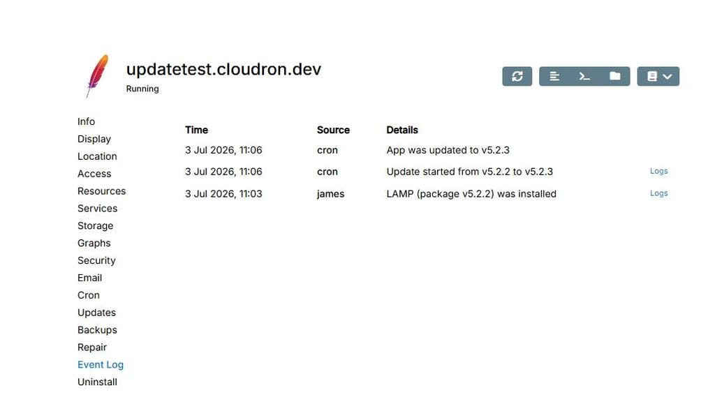

      I have tested this by installing a previous version of the LAMP app and then just waited.
