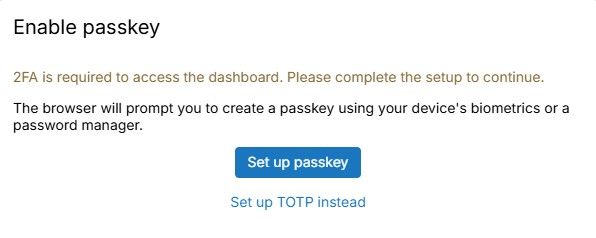

    When 2FA is enabled and mandatory, creating a new user and having the suer setup 2FA/passkey upon first login resolves in the following popup:
    As can be seen, the "profile.enable2FA.switchToToptp" is missing its button appearance.
    I hope this makes sense.
      Hello @teiluj
      Thanks for reporting, just to ensure what Cloudron version is this happening on?

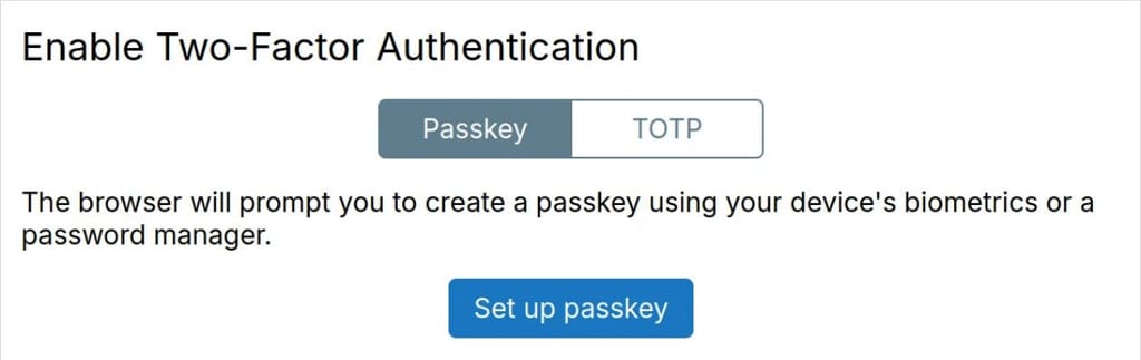

        I noticed that the picture in the docs looks different:
        Is this from version 10?

          Hello @teiluj
          Yes Cloudron 10 already fixed that issue:
