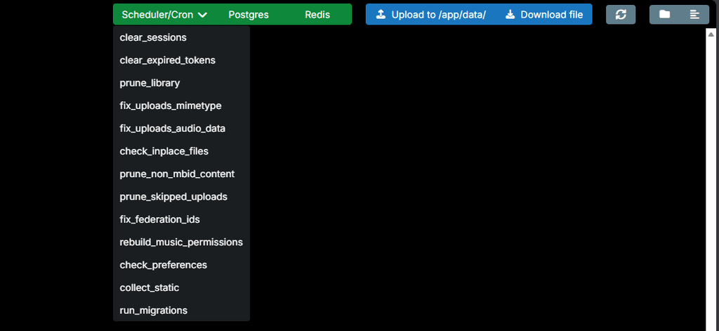

                    Many thanks, I just pushed a new docker image with this last addition :
                    which is going to allow users to maintain the funkwhale app with ease
                    documented here : https://github.com/rmdes/funkwhale-cloudron?tab=readme-ov-file#scheduler-tasks
