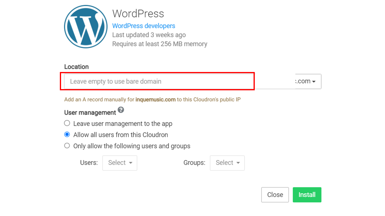

                I had the same issue and I was able to follow the steps given about setting up a redirection in Cloudron. In fact, I decided to write a full article about it to help others understand how to fix this issue step by step.
                You will have to make sure you put the right DNS entries and then set up the redirection. Read this guide here and it will help you to fix this issue.
