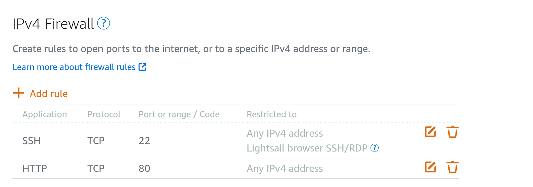

        I recreated the instance using 22.04 and performed apt upgrade and then executed cloudron-setup script, and was able to get success message. after reboot I'm trying to reach URL stated in the finish message but webpage is not opening in browser.
        Any hints how to proceed?
          @Oleksii909 by default, it seems port 443 is not open in lightsail. You have to add port 443 to the firewall.
          • O Offline
            O Offline
            Oleksii909
            Yes i adjusted firewall. Added 443 port and now it works
