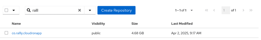

                            • A Offline
                              A Offline
                              andreasb
                              cleaning up the docker images as mentioned above basically works.
                              On my instance, there however are two app docker images that are much larger than the others:
                              rallly (almost 6GB), loomio (>6GB)
                              Is this size "normal"?
                              Is the "normal" size of the apps' docker images documented anywhere?
                                @andreasb you can check the sizes of docker images here - https://hub.docker.com/u/cloudron . But looks like it lists only the compressed size. Size of docker images is not documented anywhere . The 6GB includes many layers and the layers are "shared" across apps (the way docker works).
                                We also hvae images on quay - https://quay.io/organization/cloudron . But I think this requires login, despite images being public . These sizes differ from dockerhub πŸ™…
