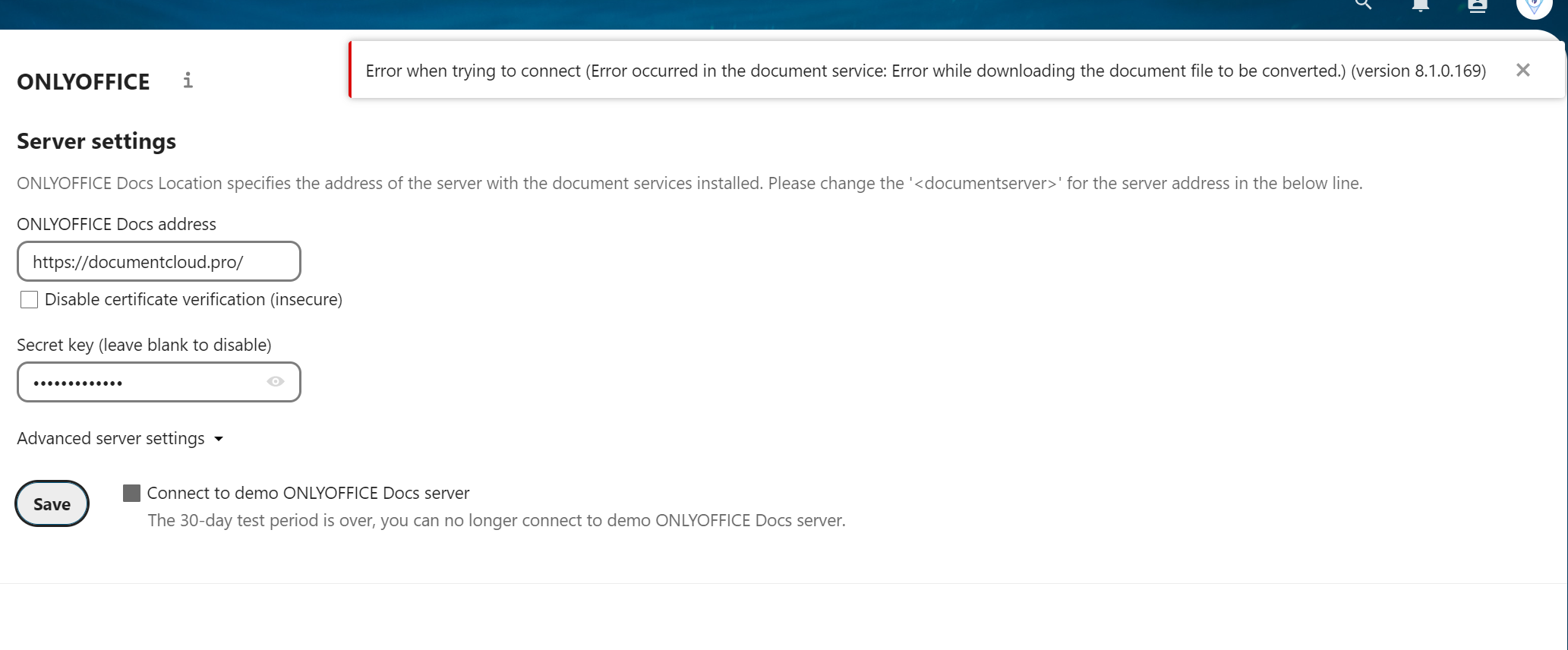

    Error when trying to connect (Error occurred in the document service: Error while downloading the document file to be converted.) (version 8.0.1.31)
    • girishG Do not disturb
      Usually this happens when the link between onlyoffice and nextcloud is not working. Did you change the onlyoffice secret ? Does it work if you use the "connect to demo server" option ? That will help narrow down if it's the nextcloud app issue or onlyoffice connection.

              The onlyoffice app seems to be up and running and also publicly reachable. Can you run the cloudron-support --troubleshoot tool via SSH on the server to verify the server and thus the apps can reach itself on the public route? This is required for nextcloud+office setups.
              • A Offline
                A Offline
                aduthapa
                root@my:~# cloudron-support --troubleshoot
                [OK] node version is correct
                [OK] docker is running
                [OK] MySQL is running
                [OK] nginx is running
                [OK] box is running
                [OK] unbound is running
                [OK] Dashboard is reachable via domain name
                [OK] Domain documentcloud.pro is valid and has not expired

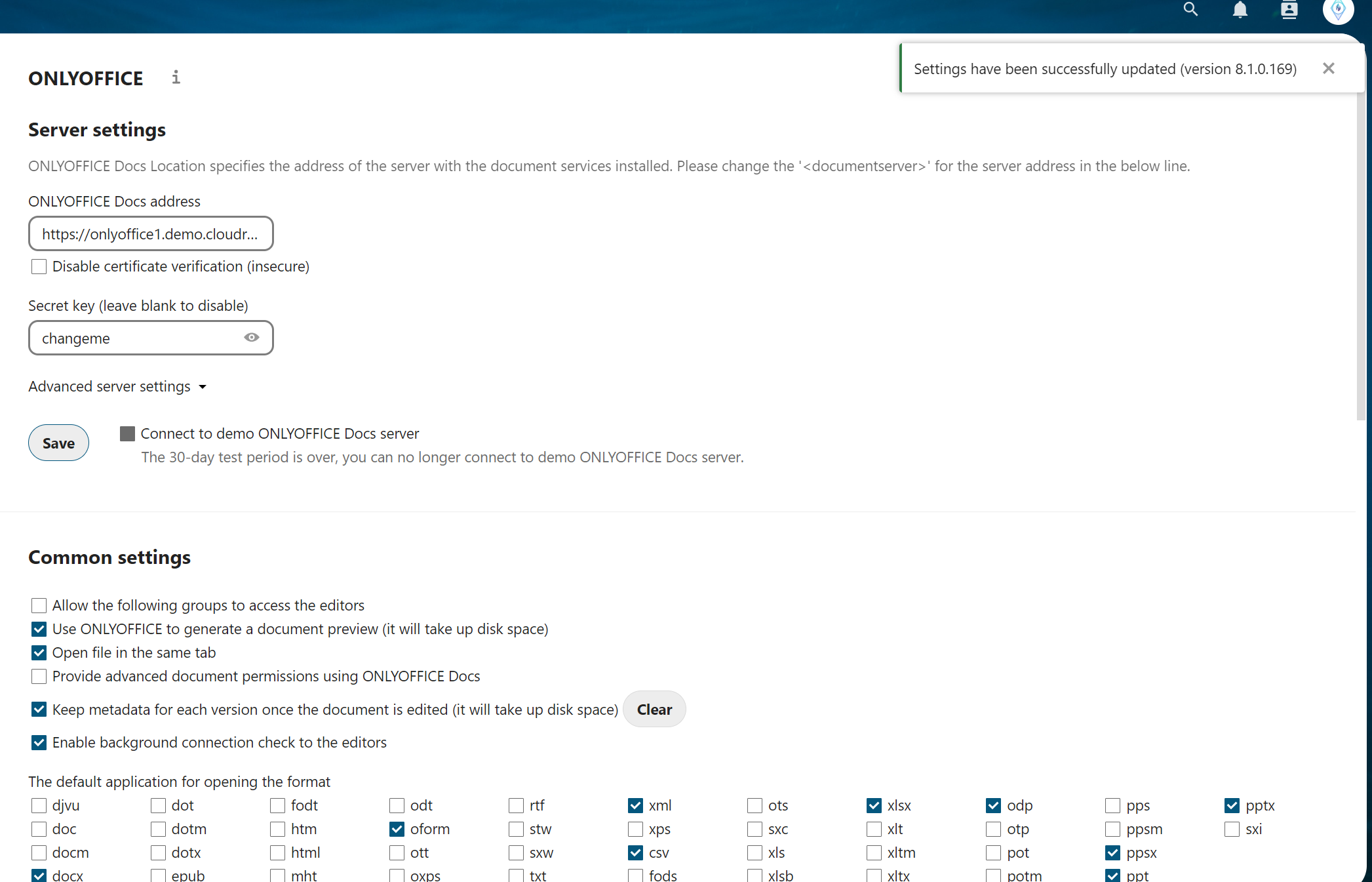

                  When I connect using the demo cloudron onlyoffice, it connects properly
                    Have you tried to re-install the onlyoffice app instance? Have you changed any configs? There shouldn't be any difference from the app instance on the demo server or on any other server.
                    • A Offline
                      A Offline
                      aduthapa
                      Yes, I have completed every reinstall, and reinstall of the app instance. It is not working.
