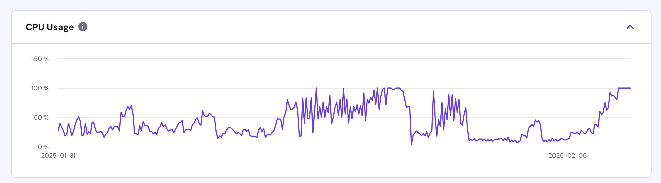

                                    Happened again. Not sure what caused it, 3 days ago, had to manually kill everything with docker stop, then slowly bring things back up. Postgres definitely down. Brought things up again slowly and everything was fine.
                                    This morning, things started dying again. Had to kill some things with docker stop, then managed to hit stop on linkding, mastodon, and nextcloud which seemed to be culprits.
                                    Rebooted, database services struggling to come up fully. Various apps that rely on databases enter not responding.
                                    Last week, capturing spikes and then bringing it down and it's fine, and then this morning everything gets pinned to 100%

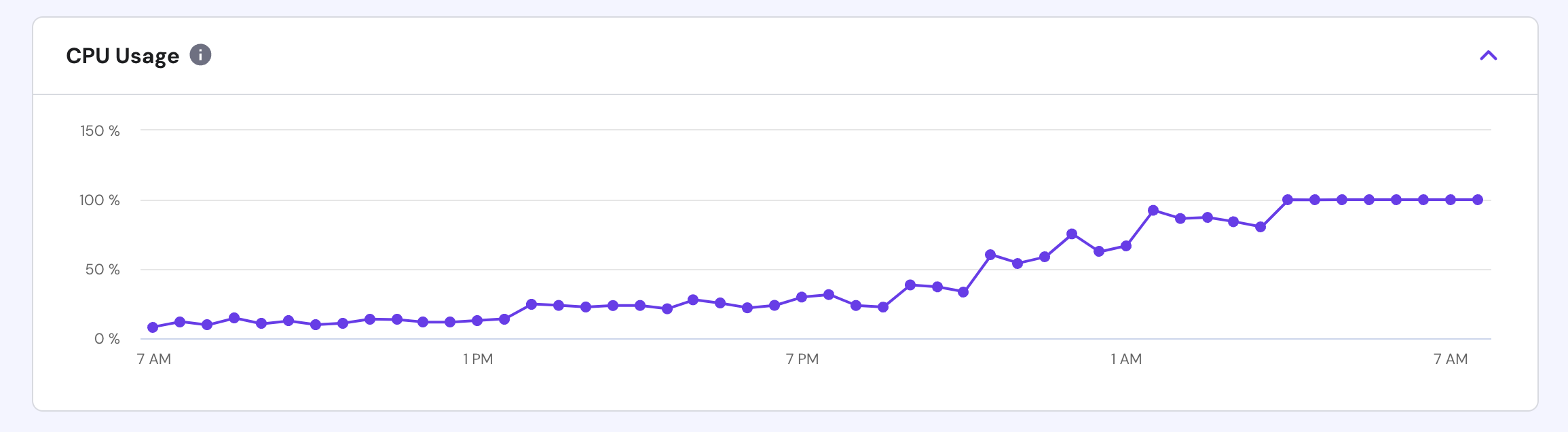

                                    Zoom in of load last 24 hours. I'm in there killing things again and it's just starting to shed load:

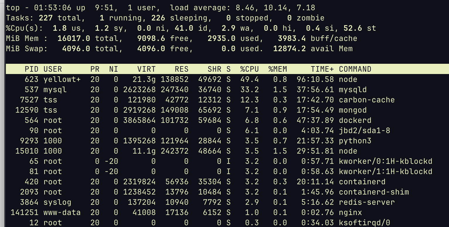

                                    Snapshot of top

                                        @nebulon working on doing that. But I like have a handful of Surfer sites and one Ghost site that really needs to stay up. If Ghost or Surfer is the issue then I'm really in trouble.
                                        Mail / Mongo / Postgres / MySQL are all at "starting" / showing as yellow...without any errors in their logs.
                                        Box is responsive enough to work with a bit.
                                        Hostinger CPU usage stats show stuff still pretty maxed out.
                                        top at load average: 7.16, 9.80, 7.10
                                        yellowtent seems to be spiking node processes over 100% CPU usage.
