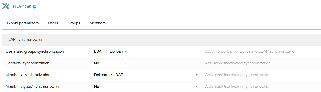

    I would like to sync members from Dolibarr (using the membership module), to the Cloudron LDAP, then using a Keycloak instance (and LDAP federation) to allow these members to connect to some applications.
    I modified Dolibarr config for members to Dolibarr -> LDAP.

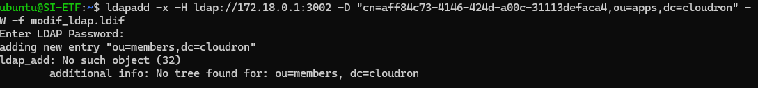

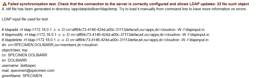

    But i have troubles with the OU member, because it doesn't exist.
    So i need to add this OU, but the LDAP account created for the bind seems not to allow it.
    How can i find the admin LDAP CN/password, and modify the scheme to add an OU ? Or do you suggest another way to sync Dolbarr members to a database, then using it to Keycloak ?

      From the docs ldap-directory-server
      Cloudron can act as a (readonly) LDAP server for apps hosted externally to Cloudron. External apps can then be configured to list Cloudron users and allow users to authenticate with their Cloudron password.
      So this might be the first problem. ldapadd will not work because of that.

        For your question, if I understand correctly, you are trying to setup dolibarr to write to the user directory via LDAP. Unfortunately the Cloudron LDAP directory is read-only so far, so that will not work. Cloudron has a REST API to create users, but that will require some custom Dolibarr extension, which might be out of scope. I personally do not know what the difference between users and members are in Dolibarr, but maybe it is an option to create the members/users in Cloudron and then sync them into Dolibarr?

          The main idea is that users from Dolibarr are users from LDAP/Cloudron (and this part works well, the script works great to copy users from LDAP to Dolibarr); but members are created in Dolibarr, then used to give access to other applications (and for that, i use a Keycloak managed by Cloudron).
          As Dolibarr allows to copy members from Dolibarr to LDAP (with the integated module, cf. first picture), i thought i can copy member in a LDAP OU (for example, ou=members), then use Keycloak to use them. But if the Cloudron LDAP is read-only, nope.
