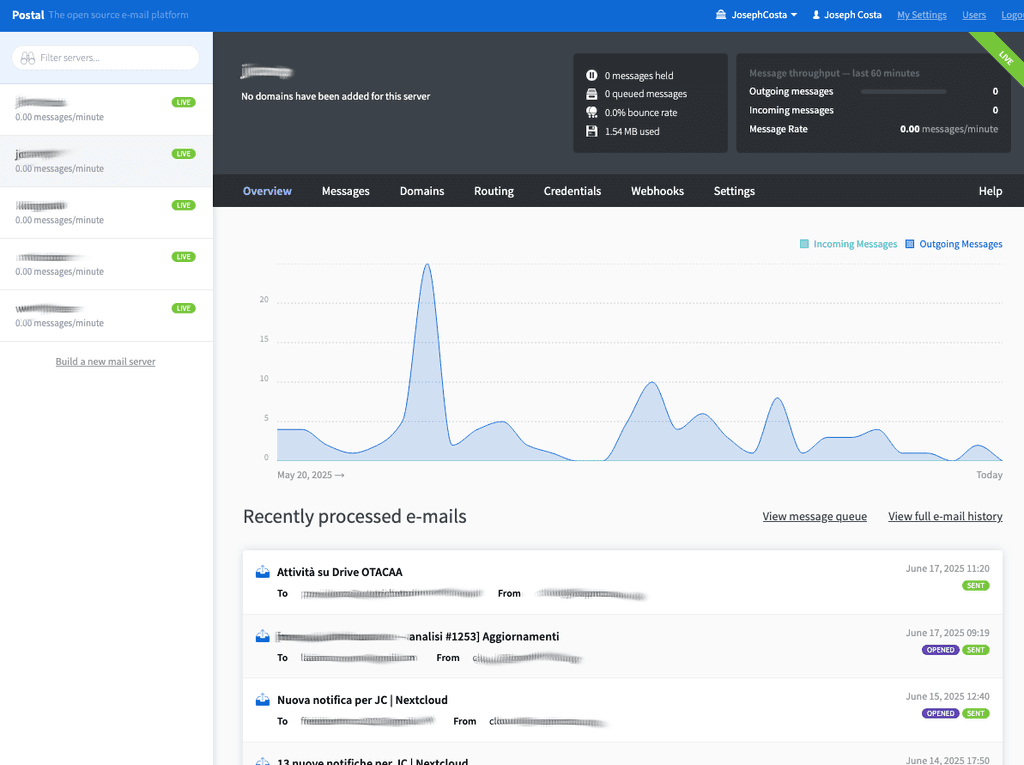

                              josephcosta
                              @bazinga you are welcome.
                              The Cloudron's built.in SMTP server is great and I use it for my daily mail traffic but there is no graph and visual history of sent mails.
                              I use Postal as an extension of smtp2go for, at least, those reasons:
                              • I always prefer self-hosted open-source software when possible, particularly when there is sensistive data like mail and e-mail adresses
                              • I started with smtp2go to have a high delivaribility guarantee for my clients, but now my postal server is warmed enough and seems to be well accepted;
                              • the free plan include only five day log which is a little shorter, in postal you can set retention as needed;
                              • there is no preview of messages while in postal you can see plain text, html, and attachment; this is useful for tests and monitoring of sent content;
                              • you can create several companies and servers with different settings and credentials;
                              • you can track activity (open and click);
                              • you can give access to clients to the reports.
