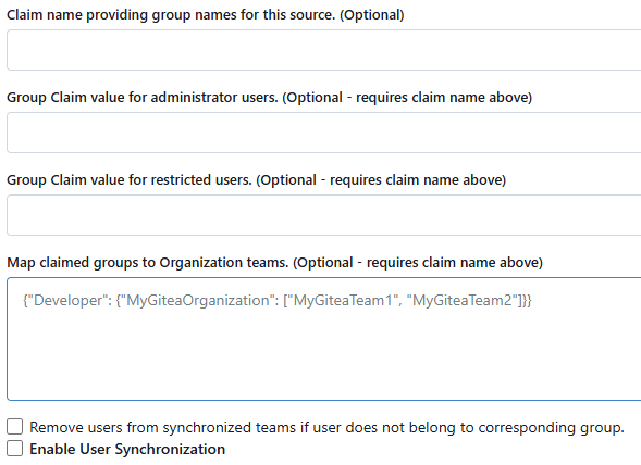

                    What if we configure Gitea admin group claims from OIDC tokens? Can cloudron add a claim to the token when the authenticated user is an operator?
                    • --group-claim-name: Claim name providing group names for this source. (Optional)
                    • --admin-group: Group Claim value for administrator users. (Optional)
                    -Gitea Command Line Reference
                    https://github.com/search?q=repo%3Ago-gitea%2Fgitea oauth2_group_claim_name&type=code
                    https://github.com/search?q=repo%3Ago-gitea%2Fgitea+oauth2groupclaimname&type=code
                    https://github.com/search?q=repo%3Ago-gitea%2Fgitea GroupClaimName&type=code
                    Ok it looks like these configs are not settable by app.ini. I'll ask in the discord and post back here.

                      Ok I found that the configuration is loaded from the login_soruce table, which has a JSON column cfg with OAuth2-specific fields. For reference it works like this:
                      • OAuth2 login starts in SignInOAuthCallback
                        • This calls GetActiveOAuth2SourceByAuthName to get the OAuth config
                        • GetActiveOAuth2SourceByAuthName loads the login configuration from the database
                        • This populates a models.auth.Source struct from the login_source table
                        • The Cfg field is parsed into the source-specific struct services.auth.source.oauth2.Source which contains the GroupClaimName and AdminGroup fields.
                      • Then SignInOAuthCallback calls function getUserAdminAndRestrictedFromGroupClaims to read these fields to get the user's admin status from the oauth claims.
                      I looked at my login_source table:
                      SELECT * FROM login_source WHERE type = 6 /*OAuth2*/ AND name = 'cloudron' AND is_active = 1;
                      | id | type | name     | is_sync_enabled | cfg                                                                                                                                                                                                                                                                                                                                                                                                          | created_unix | updated_unix | is_active | two_factor_policy |
                      |  1 |    6 | cloudron |               0 | {"Provider":"openidConnect","ClientID":"<snip>","ClientSecret":"<snip>","OpenIDConnectAutoDiscoveryURL":"https://my.<cloudron domain>/openid/.well-known/openid-configuration","CustomURLMapping":null,"IconURL":"","Scopes":["openid email profile"],"RequiredClaimName":"","RequiredClaimValue":"","GroupClaimName":"","AdminGroup":"","GroupTeamMap":"","GroupTeamMapRemoval":false,"RestrictedGroup":""} |   1752293846 |   1752293846 |         1 |                   |
                      Here you can see the JSON fields GroupClaimName and AdminGroup in the cfg column.
                      So these configuration settings can be updated today with a query like this:
                      UPDATE login_source
                      SET cfg = JSON_SET(cfg, '$.GroupClaimName', '<group claim name>', '$.AdminGroup', '<operators group name>')
                      Obviously it would be better if this setting was exposed in app.ini, but this is enough for testing. And we'll have a stronger case for a PR to add this if we come with a live use-case.

                            What if cloudron exposed a separate "roles" claim in addition to groups? Gitea could be configured to use the cloudron role claim as Claim name providing groups for this source, then set administrator as the Group Claim value for administrator users. Or set it to operators if you want to allow every operator to act as a Gitea Site Administrator.
                            In this case as long as Map claimed groups to Organization teams is left blank then there's no mapping that will confuse the app.
