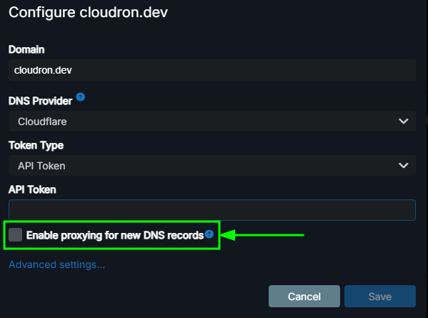

    Connecting Nextcloud to the Cloudron Collabora Online app doesn't work by default with Cloudflare Proxy enabled on the subdomain.
    The fix is to add Cloudflare Trusted IPs to your Cloudron > Network > Configure Trusted IPs & Ranges, like so:

    @girish and @nebulon I wonder if these IPs should be pulled and updated from the Cloudflare API when anyone uses Cloudflare DNS settings in Cloudron?
    Might save from much confusion potential and many support issues?
      Hello @marcusquinn
      That is interesting and might be worth considering when using Cloudflare as the DNS provider.
      Questions I am asking myself are the following:
      • should this be done by default when Cloudflare is used
      • should this only be done if Cloudflare is used with the Enable proxying for new DNS records setting is enabled
      • how often should this list be checked for updates to prevent wrong IP addresses in the Trusted IPs setting

            @james @fbartels Correct, this is just for pre-populating and updating the values in Cloudron > Network > Configure Trusted IPs & Ranges, when "Enable proxying for new DNS records" is ticked on any app.
            If you are using Cloudflare Proxying, you are implying you trust Cloudflare IPs to relay traffic.
            The Nextcloud WOPI setting, although I think it could be pre-populated, is easier to do from following the documentation, if there's any concern why you wouldn't want that internal IP address pre-populated. Although, I can't think of why you would be concerned with an internal IP address being pre-populated in Nextcloud.
