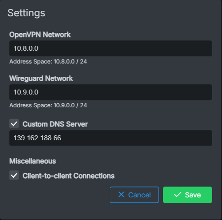

          In the VPN Cloudron app you need to configure the custom DNS Server:

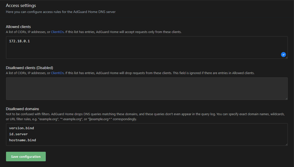

          In AdGuard you need to whitelist the Cloudron Proxy IP:

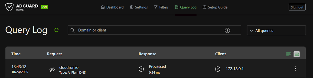

          After saving the options and enabling (in my case) the Wireguard Client I can see the querrys in AdGuard:

              Hello @3246
              Yes, as stated in the information text in AdGuard:
              Allowed clients
              A list of CIDRs, IP addresses, or ClientIDs. If this list has entries, AdGuard Home will accept requests only from these clients.
              Emphasis on only.
