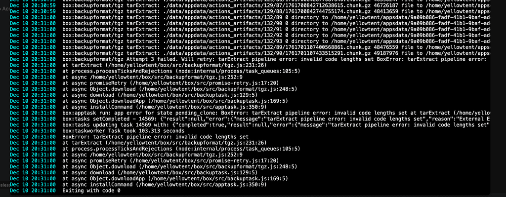

    I thought v9 was to verify backups?
    That is kinda shitty tbh, that are still issues like this.

      https://forum.cloudron.io/post/114219 -> Here it is specifically said v9 verifies backups. So is it being done? Or not? Another user posted problems with CIFS. Either way -> I doubt you are verifying backups if this still happens and there is no error otherwise.

        Again ProxMox saves the day... Its a bad feeling knowing I can't rely on Cloudron to have my back at the moment.

          @philkunz the verification signature is now saved but there is no UI yet .
          Can you check if you have a .backupinfo file next to your .tar.gz ? Inside .backupinfo there will be a sha256 checksum. Can you check if sha256 sum matches with the .tar.gz file ?

            Wait, you are simply creating a hash? Verification means you create a snapshot of the live filesystem, then actually unpack the tar and check wether that matches, after each backup. Simply saving a hash does nothing.

              There is indication now, that CIFS mounts might a have a problem of some sorts.

                My CIFS mount is on a Synology RS2423RP+ rack mounted unit with ECC usinf Btrfs... I doubt that Synology messes up the file with something essential like this, when this is the basic thing they sell to SMEs.

                  Not at all. Hashing is very well suited for data integrity. Not sure why live snapshots of file system is needed . one two three etc. Plenty of articles to read about this.
                  I think but for a start we need to know if what Cloudron thinks it saved on the backup disk matches what is currently on the disk. This is what computing a checksum will tell us.

                      I needed exactly 2 backups to work from 2 different apps in the last 3 month. Both did not work. The question is: What exactly are you hashing? Where are you creating the hash? How are you creating the hash? A hash is simply a function that can tell you with a certain probability, that a certain input is equal to another input if the hash matches. It tells you nothing about wether the backup works or not. It might increase your odds, but nothing more.
                      Just tested with another app -> also failing. And yes, there are hash mismatches. Just tested a few. Hashes do not match.

                                    @philkunz the hash is the hash of the file Cloudron saved to the storage. If they are not matching, then it either means the initial upload by Cloudron was wrong or something is off with the CIFS storage.
                                    I can't reproduce this with hetzner CIFS at least which is to say it's not a general problem. Can you get in touch at support@cloudron.io and we can debug this further . Thanks!

                                      @girish -> The question is: How many people using CIFS actually try to use backups? And how many are complaining? I'll write an email, just one quick question -> Would it be possible to have an option to read back the file after backup to compare it with the hash then? How else would one detect a backup problem at scale? Cause my understanding is, right now the hash does nothing, except show wether a backup is broken when I need it (which is too late to do anything about it, causing potential data loss)

                                        The only reason I can think of, why this is not done already by default would be bandwidth and s3 egress cost, otherwise it should be the default tbh, to at least read back what was stored.
                                          So to clarify a bit further, there are two related things mixed I feel. So the latest version does calculate the hashes of the files it expects to be on the backup storage. What is not yet added is the part where the user gets notified or warned if the file on the remote storage does not pass the validation. This will come though.
                                          The second is the actual restore issue you are facing and not really related as such to a verification issue, but the situation as such is why we introduced it, it is just not all finished (missing UI mostly)
