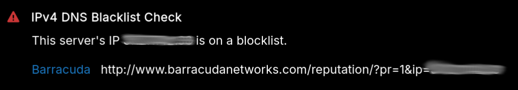

    • First one is not a bug, more a UI/UX issue. If you're in the Email/Domains/Domain view and your IP is blocklisted, after clicking the text above to get more details, it expands to this:
    If I want to select and copy the link to barracudanetworks to check what's going on, it collapses before I can hit the copy button. The first link goes directly to the removal request, which is good, but it would be nice if the reputation check could also be a link, so I don't have to open the element inspector to copy the URL 😉

      Thanks for reporting. Fixed in https://git.cloudron.io/platform/box/-/commit/5107cd28c4a0b8b362e9ee5da7151a9271db9fa3 . It won't collapse anymore and you can select it.
      The link to http://www.barracudanetworks.com/reputation/?pr=1&ip= ... itself is broken, gets forwarded to https://www.barracuda.com/ which results in a 404. Working link is https://www.barracudacentral.org/lookups but I didn't manage to add the IP as parameter
      This is actually the raw TXT record that is in their DNS. It would not be safe to render it as a link, since it is random external data. But also their DNS simply has raw links like above which are i guess broken. For example:
