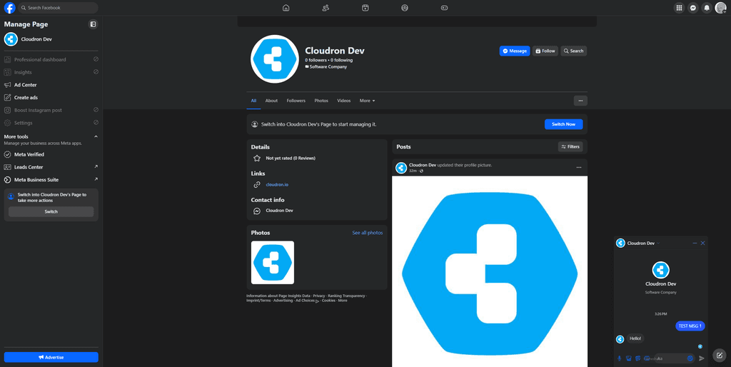

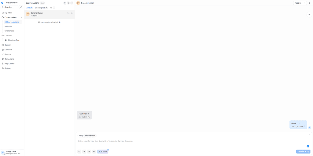

                Hello @webmaster-srpl
                I was able to set up the Facebook Messenger with chatwoot according to the official chatwoot documentation.
                I did not need to configure anything with /webhooks/facebook so I am curious how you are trying to set up the Facebook Messenger in chatwoot.
