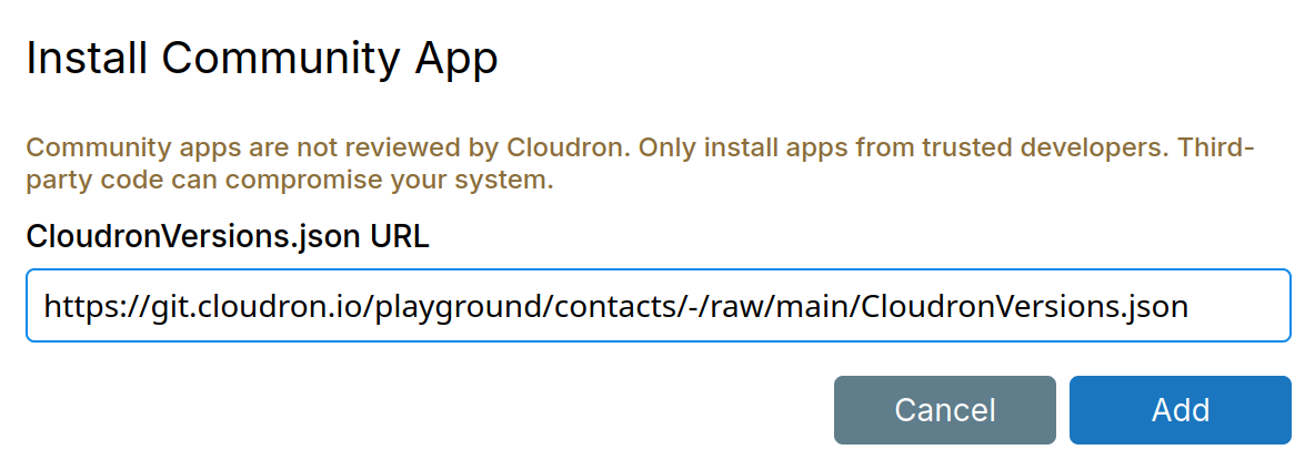

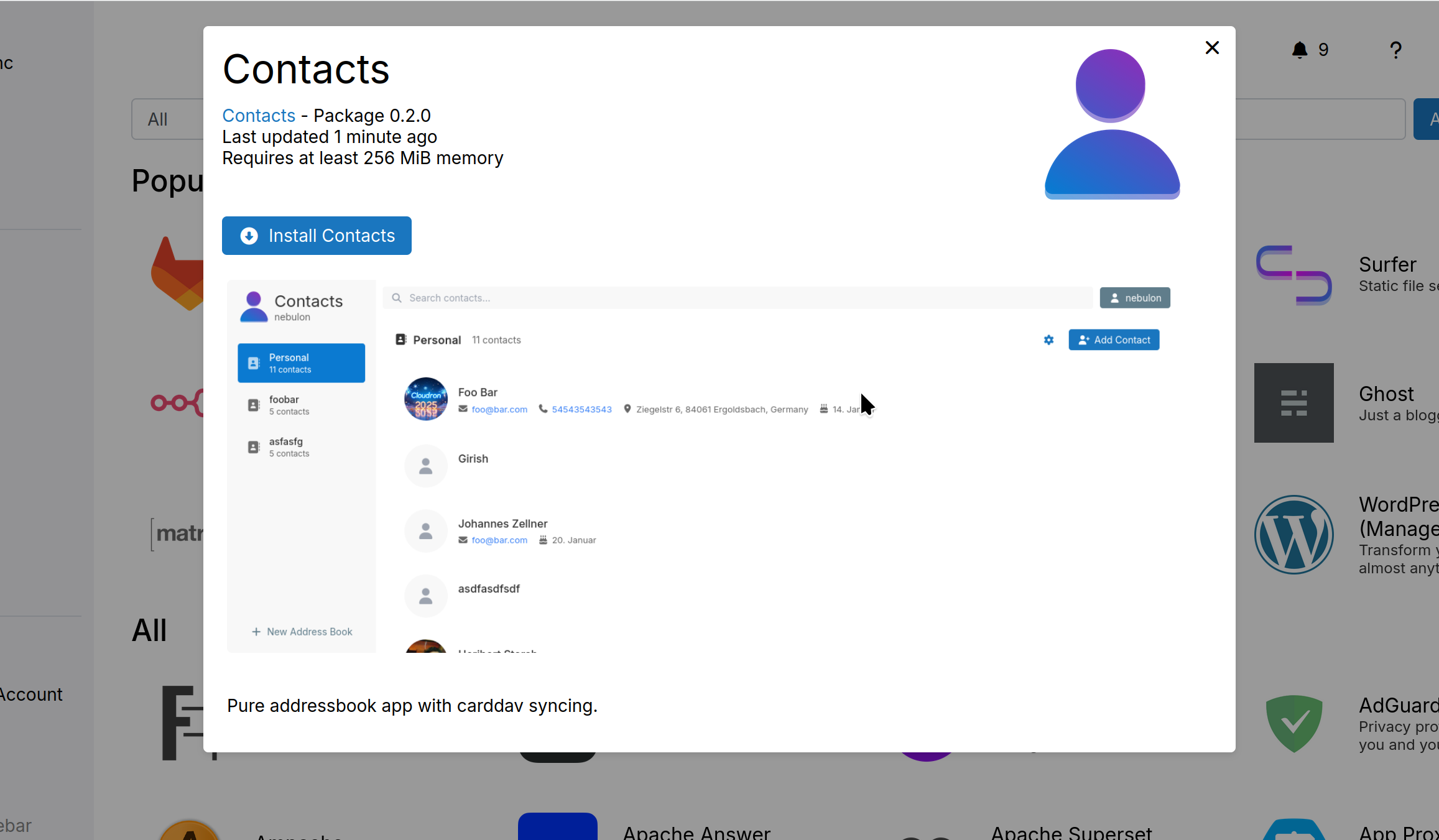

    We would like to add support for Community packages as part of 9.1. The idea is that a 3rd party developer can create a cloudron package and provide it to other users with no intervention by cloudron team. I have implemented most of the stuff. Here's how it will look like:
    • The CLI tool gained some new commands - cloudron versions init/add/update/list. This just manipulates a file named CloudronVersions.json .
    • CloudronVersions.json has to be uploaded somewhere (or serve it straight from git repo).
    • There is a button in the App store view to install a community app.
    • Test with a URL like https://git.cloudron.io/playground/contacts/-/raw/main/CloudronVersions.json
    • After this, it will show the app and install just like any other app.
    • A new packager name appears in the Info
    Other than that, updates etc works like a normal app.

      @girish awesome, thank you so much.
      Very smooth and integrated in UI 👍
      So, making sure I understand it correctly, for a CustomApp, the packager really just needs to add CloudronVersions.json to their repo (in addition to CloudronManifest.json, Dockerfile etc.) ? Neat ! 👍
      You said in a separate post you would defer the question of a catalogue of custom apps : is that still the thinking ?
      TBH, with your neat approach, I am questioning whether a catalogue is needed. Every custom app (well, 99.999%) has a topic in the forum's AppWishlist category, and the packager can just post a message there with the repo details, including the relevant CloudronVersions.json file.

        @timconsidine said in Update on community packages:
        Yes, correct. cloudron versions add simply creates CloudronVersions.json with the current manifest and current build information. Hopefully, it's all as obvious as I am making it sound 🙂
        From the installation point of view, the repo can be closed, docker image can be private. Only the CloudronVersions.json has to be public.
        I have added two new fields on the manifest - packagerName and packagerUrl.
        Going forward, the icon in manifest will be deprecated. We will use iconUrl instead.
        Yes, let's think about how people discover these versions files once we have released this.
