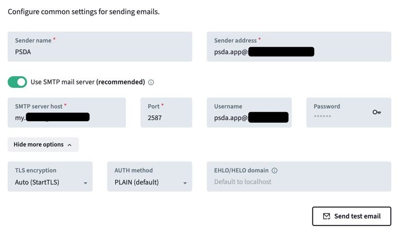

    Hi there!
    I just confirmed that email works in PocketBase on Cloudron when using STARTTLS on port 2587.
    What confused me is that PocketBase’s default SMTP port is 587, but on Cloudron nothing listens on 587, the provided ports are 2525 (plain), 2587 (STARTTLS), and 2465 (SMTPS).
    Is the default 587 simply not applicable on Cloudron, or am I misunderstanding how PocketBase is expected to integrate with Cloudron’s mail relay?
    Thanks!🙏

        Hello @jesperbllnbm
        Due to the way PocketBase is developed it can not connect internally to STARTTLS without the certs.
        This works for mosts apps, but some don't like it.
        PocketBase is requiring a valid mail server certificate to send email internally, thus 2587 is used.

                        Hi
                        I don't succeed to make pocketbase work with cloudron SMTP
                        I always end up with timeout errors
                        What am I missing
                        • V
                          V
                          Valexico
                          wrote on last edited by Valexico
                          Hmm it appears that when sending test email, pocketbase is showing timeout but after a while I do receive the test email in my inbox.
                          This slow response also make login very slow because pocketbase is trying to sen email alerts. I am not sure where can be the problem.
                          From pocketbase point of view, the email request gave timeout
                          From user point of view the login time is slow (~30 seconds maybe) -> workround : disable login alerts
                          But emails do get sent at the end ? At least test emails

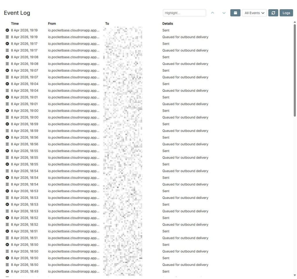

                              • robiR
                                Could it be hitting throttling limits?
                                  Hello @robi
                                  The Cloudron mail server was not throttling, I ensured that.
                                    Hello @robi
                                    @james I was thinking fw not mail.
                                    Next thing would be to see what the code does
