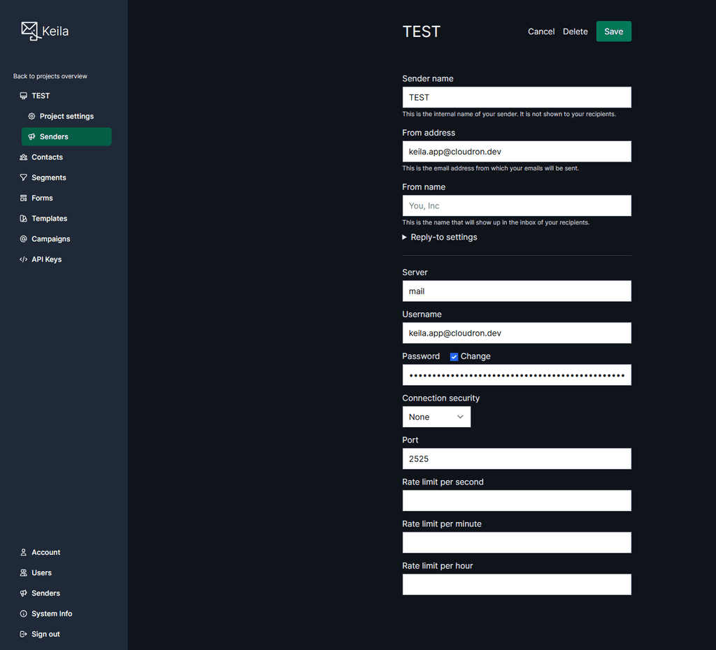

      Hello @mononym
      Currently, there is an issue with the Keila shared mailer admin ui.
      See: https://github.com/pentacent/keila/issues/501
      @brutalbirdie did write a PR to fix the issue https://github.com/pentacent/keila/pull/509
      Without this fix you have to setup the mailer for the campaign.
      To get the credentials from the Cloudron App, open the Web Terminal and run:
      printenv | grep -i "CLOUDRON_MAIL"
      This will give you all the details.
      Example mailer setup:

            @james said in How to create Sender from outbound mail ?:
            I saw that error after I started this thread. My guess was that it wasn't implemented yet as the app is marked as unstable.
            That works perfectly, thanks !
