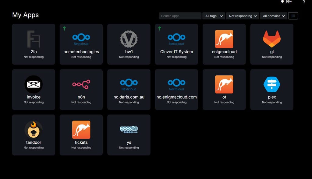

    looks like I found a bug maybe ( with all service down )

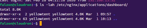

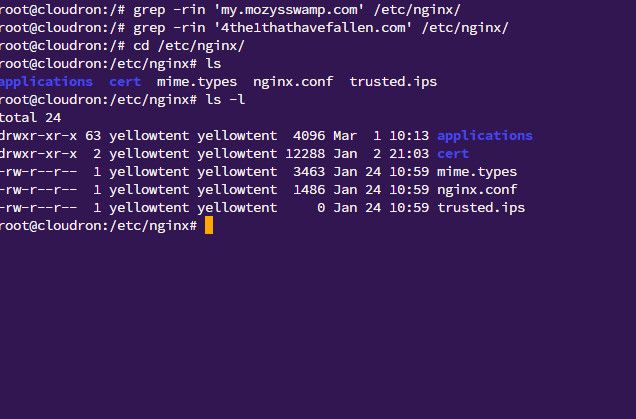

      Hello @nozy
      Can you please share the content of the following folder:
      ls -lah /etc/nginx/applications/dashboard/
      and also the output of the following commands:
      grep -rin 'my.mozysswamp.com' /etc/nginx/
      grep -rin '4the1thathavefallen.com' /etc/nginx/

        @james Hi James looks like both are gone happy to go back to the my.mozysswamp.com ( just can't see it in the backup ) all 3 domains have the my.XXX setup to the right address

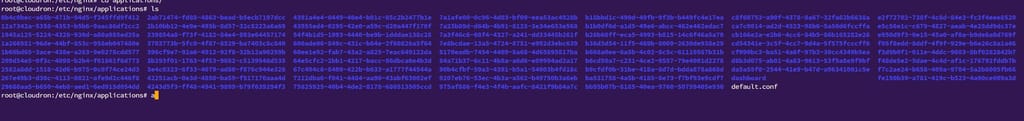

          @james app is ok form what I can see dashboard has 0 files.

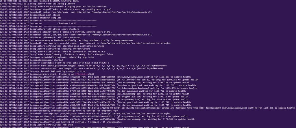

            tail -f /home/yellowtent/platformdata/logs/box.log
            While tailing this logfile, in another shell session, restart the box service.
            systemctl restart box.service
            If any errors or other warning appear, please report them here.

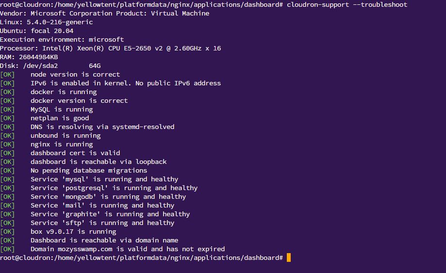

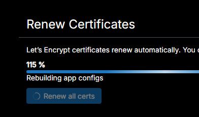

              @james
              looks like it is up .... its book in for this weekend in for this weekend to full upgrade just thinking if it time to move from hyper V to Promox...
              yep that why I move it over to the temp domains for the upgrade if I had to roll back.
              looks like the config is back
              started it looks ok to me

                    will was sure I got a way to easy ....
                    ssl site are down for what I can see
                    renew the SSl key at @ 115% love code it does fight back
                    now all the SSL site are down
                    all look good till you login to one get SSL error
                    J 1 Reply Last reply

                      @Nozy I can take a look since you have given support access.
                        @nozy the db connections are simply hanging for some reason.
                          @nozy I had to restart docker since there was a problem with the docker network IPv6 connectivity. Now the apps seem to work.

                            Thanks looks good I have it book for this weekend for backup and upgrade
                              @joseph is there a way to detect this with cloudron-support or box and have it autoheal?
