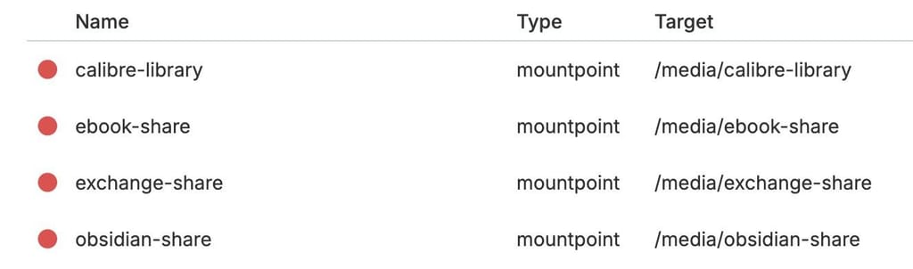

    I noticed that my Calibre Web instance is no longer working because the mounted volume containing the database could not be found.
    According to the dashboard, no volume was mounted at all, so I'm posting this here:
    I use Syncthing for the remaining 3 volumes, and interestingly enough, there are no issues there—the app (and the shares) work as usual

    • I found this case on the forum that sounds similar and tried to follow the steps, but there is no mount command with my volume id available

      Hello @hpz24
      Then you should use filesystem as the volume type.
      • J
        @hpz24 mountpoint means Cloudron does not manage the mountpoint. It is the user's responsibility to have them mounted before the containers are running. So, I guess the question is: do you have .mount files or fstab entries for these mountpoints?

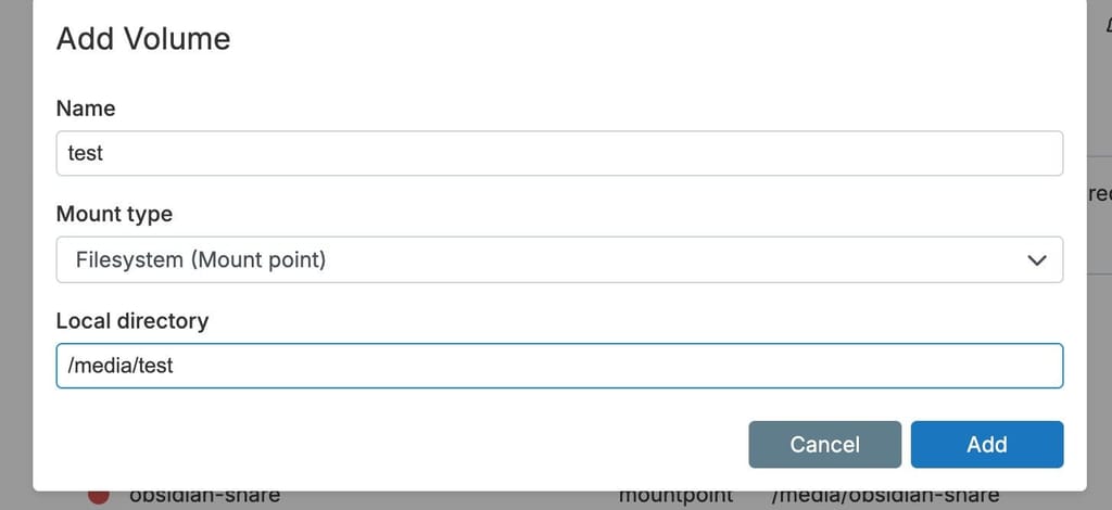

          Hi, thanks for you answer!
          No, I haven´t any fstab entries or seperate .mount files, but I created the volumes in the dashboard:
          • Create folder in /media (e.g, /media/test)
          • Create volume (screenshot)
          • Volume is available in the apps (like calibre)
          The idea was to separate the data from the app, since there’s no need to back it up. Was that the wrong approach?

            Hello @hpz24
            Are each of your /media/(calibre-libray|ebook-share|exchange-share|obsidian-share on your server really a separate drives or partitions that are mounted?

              Hello @james,
              none of them is a separate drive or partition, just directories that I´ve created before I set them up as volumes in the dashboard

                Hello @hpz24

                  wow, that was easy: changed the type to filesystem and the apps are working again.
                  I have no idea why or when that changed to the wrong mount type.
                  anyway, thanks for your help, resolved 🙂
